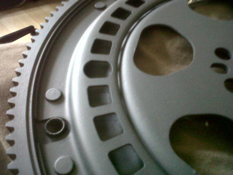

hmmm, might be onto something here, I was cautioned about doing the same thing, by loosening the crank pulley bolt and relying on the dummy sensor can damage the starter ring gear.
I don't know the symptoms - but timing out and overfuel, it's possible.
There's a Jaguar special tool that holds the pulley as you undo the nut...
The other pic is of the starter ring and the slot with curved top and bottom is the where the locking tool slots. This might be worth checking out...
Attached Thumbnails 98 XJR running rough!-pulley-lock.jpg   98 XJR running rough!-fly.jpg
warrickUK (10-10-2012)

Noooo... didn't use the locking tool to undo the crank bolt... the slot for the locking tool remains OK!
Does the crank sensor rely on the slots in the flywheel to generate a signal?
