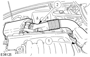

If you look in this picture, where the bend is going to Throttle Body, that's where the "silencer" piece would be, but I'm pretty sure that the R models didn't have it.

Just looking at the diagram and that area is at the opposite end I am asking about. The end I am asking about is adjacent to the firewall.

I wasn't referring to where #2 is, I meant the part behind that where it makes a 90 degree turn to the throttle body ( #1 ) , the firewall is on the RH side of the pic, is this correct?

Yup I misread that. Yes that's the area in question.

Yeah in the pic that ericjansen posted, that straight piece coming off, its a silencer, doesn't add or take away any performance, unless its cracked and starts a vacuum leak, which I've seen happen quite often in the past. Thanks for posting the picture ericjansen.
