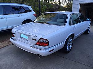

I read some of the posts in this thread and decided to give clay bar a try. Unfortunately I finished kind of late in the day so the pictures don't really do her justice.
Attached Thumbnails Anyone Claybar?-img_4889.jpg   Anyone Claybar?-img_4890.jpg   Anyone Claybar?-inkedimg_4893_li.jpg

Default Little better light today...
Snapped a couple of pictures with a bit more sunlight.
To clay bar and polish the car took me about 5 hours so either I did something wrong or I am just getting old!
Attached Thumbnails Anyone Claybar?-f9b04d2b-b072-4dce-b58b-4a1d08abfe50.jpeg
Really shows the shine in this pic Harvest......................that is a beautiful car, I love the X308 in white.
