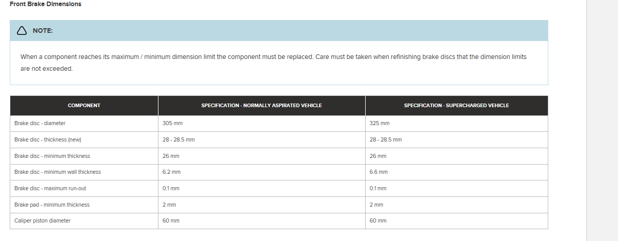

Yes it can..... did you check run out on both sides of the disc?
I would think that if the bearing was causing the vibration, it would do it even without braking, might depend on what's failed and how it failed I supposed.
Usually when steering wheel shakes while braking would indicate warped discs/rotors...
Since you say when rotating the wheels by hand, one appears to be tighter than the other, then you may have a faulty bearing.
Just for future reference - the run out spec allowed for 97/98 XJ 308 is .1mm as per Topix.

Run out was 0.02mm on both sides... Measured like this:
The 0.5 was as said a rule of thumb. Less ist of course better.
