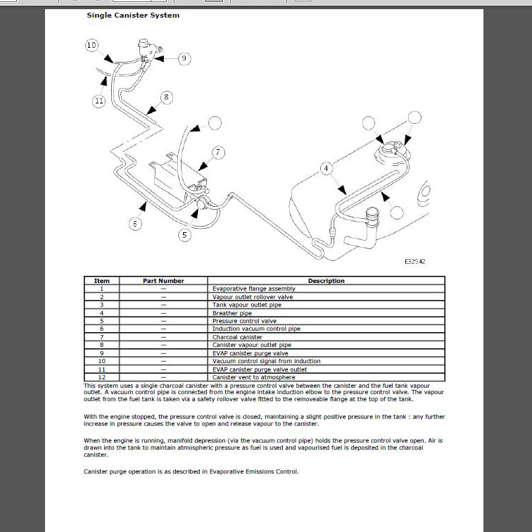

Is this the same setup you have David?

Sean: It's had both pumps done under my watch in the last year, although the car has had this problem since I've owned it. Which pipe are you suggesting might be blocked?
Highhorse: That looks like my set up, yes. Hadn't seen that particular picture diagram before, but it's helpful in identify everything, that's for sure.

I think the system is a double canister version of this with a link pipe to the other side, I'd have to get under the car to confirm it. US emissions spec 100 might be different. There's a purge valve on the front bulkhead the vapour line goes to and solenoid, have you checked them out? (9 & 10)
The tube I was referring to has the U bends, goes to the pcv and can get kinked. See the pipe circled.
