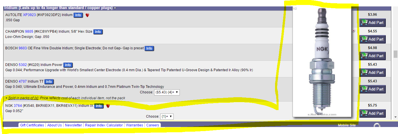

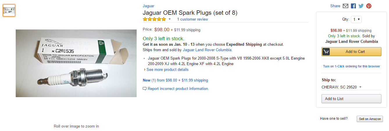

Old 01-07-2017 | 06:33 PM
omgimali's Avatar
Joined: Jun 2016
Posts: 1,487
Likes: 107
From: Cheraw SC
Question
Ok so the #1 picture is the Iridium plug on rock auto, #2 picture is the Double Platinum on rock auto NGK R, #3 Picture is the OEM Jaguar Dealer Spark plugs
#4 Picture is a closer look and as you see they are NGK R Double platinum's? or are they Iridium with R?..
Attached Thumbnails Car won't go above 2,500 rpm-ngk-8.png   Car won't go above 2,500 rpm-ngk-r.png   Car won't go above 2,500 rpm-ngk-r-jag.png   Car won't go above 2,500 rpm-ngk-r-jag-ama.png
