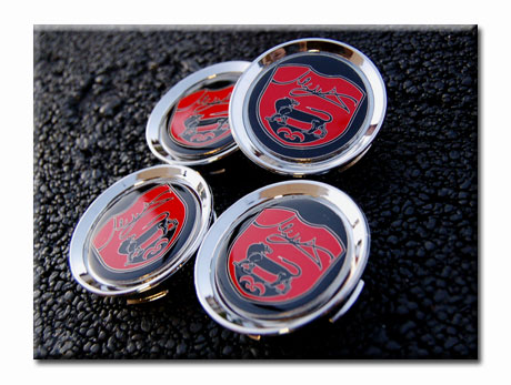

What's the best way of removing these caps without breaking the tabs?
I am thinking of ordering some of the Mina Gallery ones as a little dress up.
Thanks.

I'm not sure there's a good way to remove them without breaking the tabs, except to be very careful and to do it from the inside. The tabs just seem to get brittle and break off no matter what you do -- poor design, IMHO. I have an old Mazda Miata that has BBS wheels and the center caps come loose and fall off and cost a fortune to replace -- so it's not just the Jaguar.
