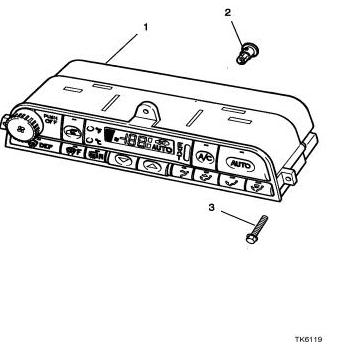

Forum member Squish requested a JTIS21 extract on Climate Control Panel(Center Console Switch Module).
Update - added another JPEG file showing the Climate Control Panel taken from JPEC (Jaguar Electronic Parts Catalog):

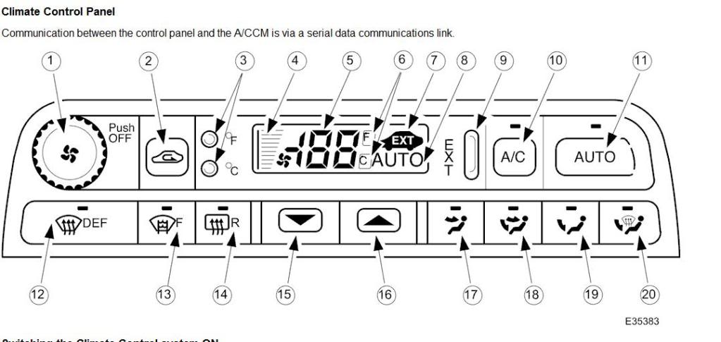

Here is a JPEG file I created from the JTIS Climate Control System Panel from the Description and Operation section:
