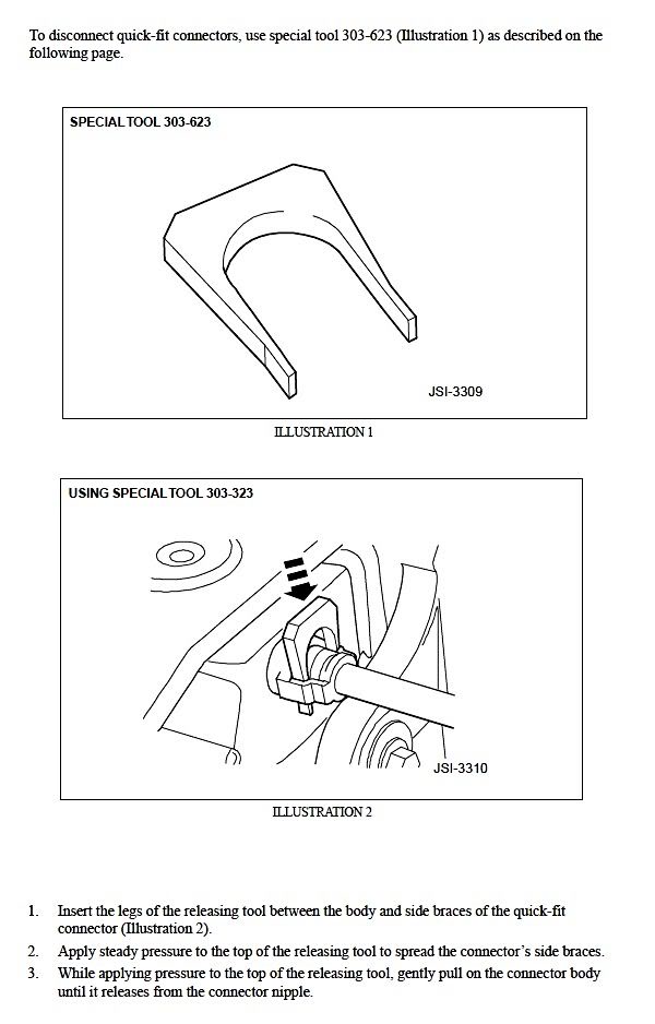

Anyone got a photo of this tool !
Be nice ...lol
The factory disconnect tool for cooling system bleed pipes, situated on front end of
Part Load Breather Hose at front end of
left cam cover (looking from drivers seat)

Lots of info on the coolant hoses.
You can see how they are crossed coming out of the expansion tank, this "looks" wrong, so a lot of folks put them back incorrectly.
Another reason to take lots of pics whenever you undertake a repair job.
