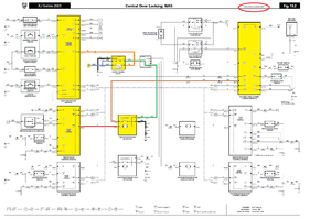

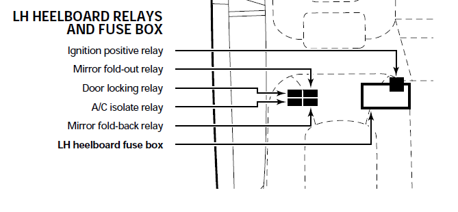

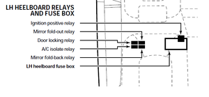

A " Hard Reset " may straighten everything out . But in case you can test and run with a 9 volt battery ( I assume ) the locking actuator electrically without pulling the door trim off . First look at Fuse # 2 / 15 amp at the RH heelboard fuse box , labeled as the square 29 on the print . If you don't see anything wrong with the fuse swap the door lock relay in the LH heelboard fuse box with one in the same area ensuring they have the same part number .
The door lock actuators do fail mechanically other then electrically .
