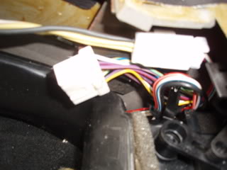

When you remove the Armrest to find the wire, it will either be plugged into your phone module, or like mine, it will be tucked back next to the vent outlets in the back of the console. It is a 10 wire cable with a white connector attached. You will either need to cut off the white connector and connect to your bluetooth device, or somehow find the mate to that connector. Read the link you gave carefully to avoid shorting out any wires as they are live (recommend disconnecting battery).
Again, this setup probably will NOT allow you to use the keypad on your stock stereo to dial, but it will allow you to hear the phone call through your stock stereo (Sound is Awesome), and automatically mute your stereo music when the phone is in use. It will also allow you to control your in-call volume using the volume control on the stereo or steering wheel.
If you are hesitant to try this method, you might print out the pages on the link you posted and take them to your local stereo/bluetooth shop and see what they think. If they have experience installing bluetooth, I'm confident it will make sense to them.
I'm not sure where you are located, but if you are near Sacramento, CA USA, I'd be glad to show you where everything is in the XJR, and give you a demo of how it works in my wife's car.
It's late here now, but let me know if you'd want them, and I will take a couple photos of the wiring harness tomorrow.
Update: Photos uploaded. All taken from Driver's Seat for Orientation.
Console in tact:
Open showing placement of 4 screws to remove. Also note orientation of the latch at arrow, for reinstallation:
Lift out the whole unit as one piece. The wires will either be connected to a phone module if equipped, or tucked in here like this:
Carefully pull it out so you can get to the plug and wires:
This is the end of the plug if you decied to try to find a mate:
As far as connections to which colors, refer back to the link you gave earlier. Like I said, a Bluetooth Installer will have no problem with this connection.

I've been excited about this thread all week. My car had the factory phone, I took the console apart today and found all the connections. I looked on line at the different Parrot units, and there was a link to a group that makes pre wired harnesses.
They said if I supplied the connectors, they'd make the harness for the parrot unit. I found the connectors on line at: http://www.masterdistributors.com/
The part numbers for the connectors are listed in the PDF Astigmatism posted a link to early in the thread. The male connector (car side in my XJ8) is 174465, the female connecton is 174932. There is a dash 1, 2 and 3 part number, I'll have to call and see what that means, my guess is size. Also, I'm not sure what the part number for the pins is or if they are included with the connector.
I'm thinking I'll just make my own harness. In fact since I have the connector from the phone I'm considereing just hacking it up to leave the car side in tact.

I have a sample AMP connector being shipped from Tyco, it does require pins. It doesn't appear that this is a very common part any more. I did find out the -1 is white and the -2 is black.
As far as the console box, that is a good idea to keep it for routing but it has a 3/4 inch slot on one end hidden by a plastic plate, with the plate in place the slot is hidden but it eats up a 2/3 of the space in the box. If you're interested, ill try and post a picture if I can figure out how.

I made up my connector to hook to the factory harness. For the 3100 it takes 6 connections, so far all the documentation people have provided was accurate. I needed a few dollars in heat shrink and solder to make the connections "factory".
I took down the upper console and ran the microphone wire across the headliner, down undwenwatht the trim on the pillar, under the dash on the drivers side and into the center console, I had about 6" of wire left when I was done and getting that 1/8" jack fished through was probably the hardest part. I had to use a more rigid pull or push wire with a little piece of tape. My car had the factory phone before so I just mounted the new mic where the old one was.
Then I ran the parrot control cable fron the dash by the trip computer down through the console. I eneded up pulling the radio to get room to fish the wires through. Also thanks to someone elses previous post and the JITS I was able to remove the ski slope without dammage, but I did learn that for the slope and radio, it's best to have the shifter in N or D to get clearance.
I mounted face of the unit to the dash using some sticky velcro that came with the kit.
I did all that last night in about 2 hours, slow and steady. This morning I clamped in the cable and made the test run, everything worked. I buttoned up all the consoles and trim and replaced my old phone console insert with the deeper non phone one, the clearance was tight but I velcroed the blue parrot module to the inside of the console housing to get it out of the way and the wires are thin so they pass underneath just fine.
Total project installation and clean up took around 4 hours.
So now for the assessment.
Calls sound clear through the front two speakers and the microphone seems to work very well, I made a couple of calls and the recipients couldn't tell the difference between my cell phone and the car unit. I moved around and talked at different levels, the microphone caught it all.
I used the "line in" connection and the volume buttons on the radio and the steering wheel adjust the volume of the speakers like they are supposed to. I was concerned I might have to use the Parrot controled signal so I made that connection temporary with a couple of wire nuts, I soldered and heat shrunk it once I had proven it out.
Because there is no ACP network connection, you can't press the phone buttons on the steering wheel to switch to phone or hang up, it just flashes "no phone", but because of the mute wire function, when a call comes in or when you make a call "PHONE" shows up on the radio display.
The display on the Parrot unit is nice, you can set up audio commands or use the buttons and knob on the front. I think I'll set up the voice commands so I can be more hands free, I haven't fully tested the features, but it looks like there are several.
So overall I'm quite pelased with the project. Thanks for everyones help, this has been a fun project.
As Hannibal used to say in the A-team, "I love it when a plan comes together!"

So, yeah, I forgot to mention, if hte radio is off, the Parrot unit is still on and you can make and recieve calls normally, the radio display comes on and says phone when you send and recieve a call. It goes off again when you hang up or the call ends.
If the radio is on it mutes the stereo, when the call ends the stereo kicks back on.
I thought about splicing the factory mic, it is a coax cable, I thought about just re using the factory connector, the reason I decided against it was the Parrot came with a really thin cord (say 24 gauge ish) and an 1/8th inch mini jack. I was worried about being able to re connect these tiny wires and if I screwed it up I didn't want the hassel of making a new cable. In retro spect, I think I could have done it, but I'm happy enough with the result.
I also didn't want to stick anything to the wood, I've mounted it to the leather (lesser of 2 evils?) just below the wood trim and trip computer. I routed the cord through the seam between the wood and leather. It came with a couple dash style mounts but I'm sure you could make them work in a vent if you wanted.
