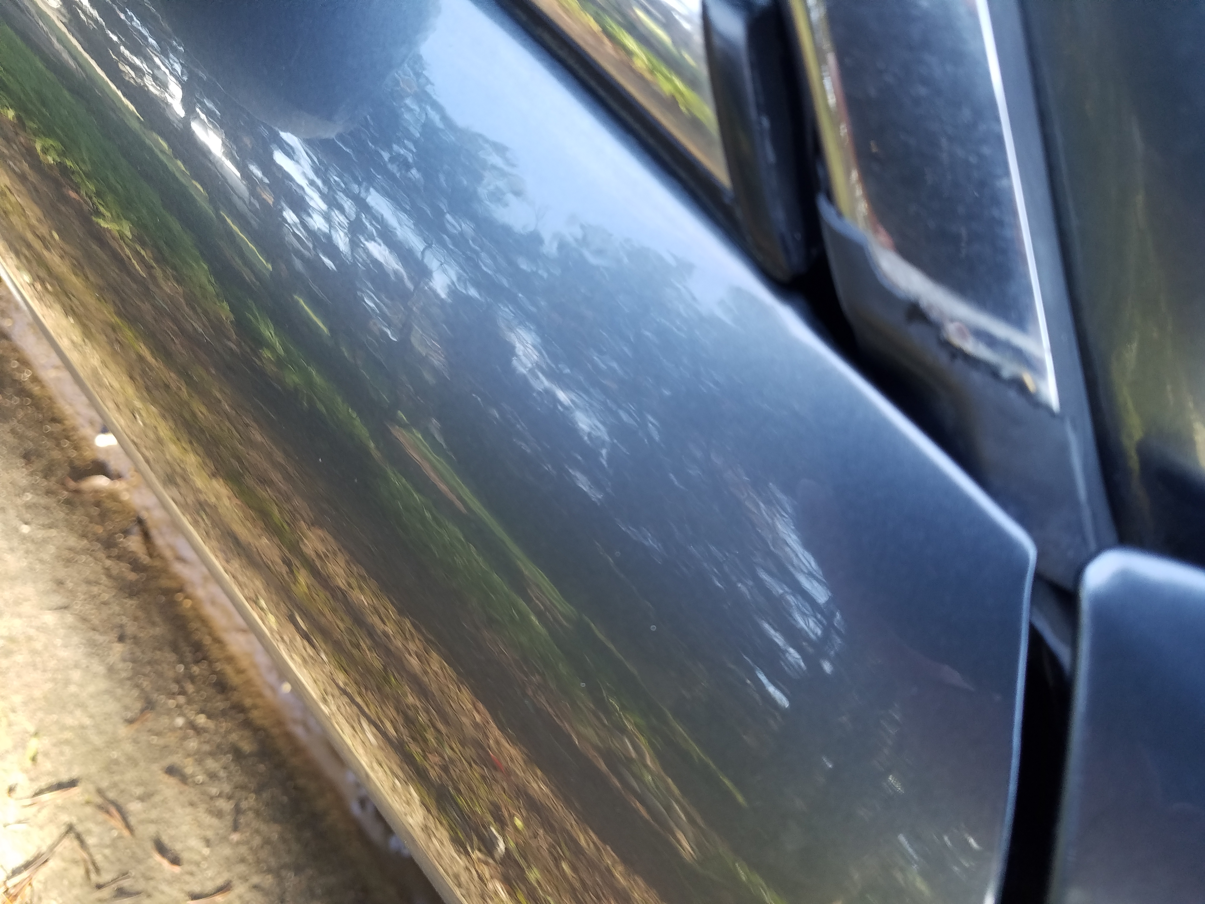

Here are a few pics.
Attached Thumbnails Fool's Errand or does the part exist?-20170222_084321.jpg   Fool's Errand or does the part exist?-20170222_084326.jpg   Fool's Errand or does the part exist?-20170222_084340.jpg
