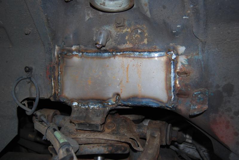

I have the same issue on a ex-Manchester area XJ8. Is it possible a picture of after the welding? I am curious how the double skin patch looks.
+1 to the 'after' pic for comparison with the original damage pic.

Got your eMail and attachment. Here's the pic:
What's the Front Crossmember Vee Mount like after all the heat in that location?

The rubber front chassis mount did start to get hot. At the first sign of "smoulder" we dosed it with a water spray, let it cool down and then carryed on.

I think you were incredibly lucky to find someone of that caliber to do it for that price.
The welding looks very pro to me.
nurquhar did you pull the engine/trans just to do this?

No. Left it all in place. We just had few damp rags around to stop any MiG splatter going ABS cables etc.
I think if we had attempted the job with Gas the rubber would have been on fire. The MiG is much kinder.

Has the new weld touched the vee mount at all ? It looks like it has on the pic i hope not for your sake replacing it is gona be a bit of an **** tbh
