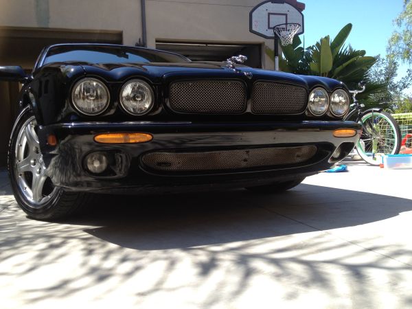

Hi guys,
I'm almost ready to pull the trigger on a nice, low mileage, black on black, 2003 XJR. Everything is clean and shiny on it except for a few minor interior items and the front shocks.
![](https://www.jaguarforums.com/forum/attachments/xj-xj8-xjr-x308-27/30116-front-shocks-03-xjr-3nf3gf3le5l15kf5m8ccec313ab19c70317d7.jpg?dateline=1358103672)
The front shocks are original and need replacing. The front wheels bounce like basketballs as it rides now.
So, the private party seller said that he'd either have his mechanic replace the front shocks ($1250, he says $500 for each shock and $250 for labor) or he'd drop his asking price by $1250 if I want to take care of the front shocks myself.
I've sifted through the forums and the web to find the best deals on compatible front shocks for the XJR.
Bilstein is the way to go, right? These look to be the lowest priced ones I can find so far. Are those appropriate? Will they be as sturdy, reliable, and nice as the OEM shocks? I also saw these somewhere else on the forum. What about them?
Also, I have access to my friend's garage. He has replaced everything from engines to shock absorbers and struts on his '05 Mustang GT. If that's the case, do you think we'll be able to replace the Jag's front shocks ourselves using the tools in his garage?
Thanks all. I'm pretty excited to be a Jag owner.

You need these shocks, your car might be adaptive control type, if there are some wires on top of them.
No particular tools, no spring press needed, just a balljoint press for the top wishbone.
