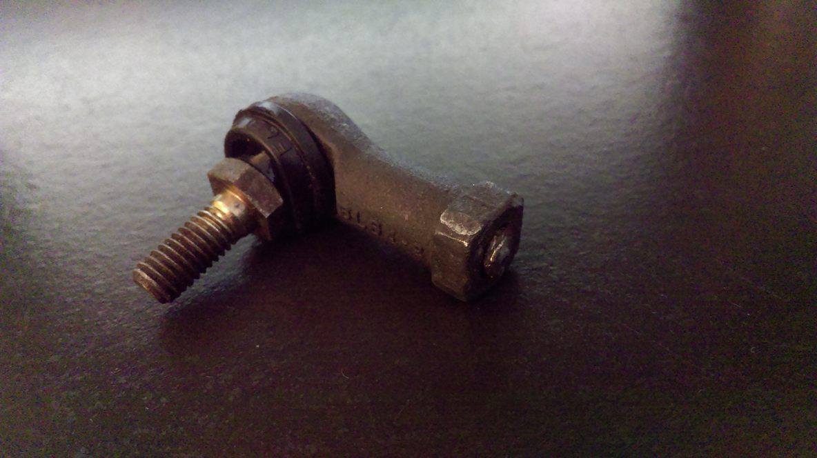

Angry ball joint snapped off!
well i think that was the problem... The cable's adjustment nut possibly slid (over the threads) all the way out making the cable end too long.
I went to adjust the cable underneath the car and it was too long to hold the trans into neutral (it was pushing the gear selector in the car into "R") the inside the car adjustment nuts did not matter. The ball joint part of the cable under the car was too long so I went to shorten it and it snapped off.
All the pictures i've seen of this part of the cable have hardly any "threads" showing next to the little nut. Mine had a good 3/4" of threads showing, so I'm assuming it somehow stripped and just slid all the threads out making the cable too long. I was able to loosen the lock nut but the ball joint part was not easy to screw further in. I was using plenty of PB blaster. I got it about halfway to where it should be and it snapped. this picture shows the lock nut i'm talking about, only there were almost an inch of threads showing and after the nut and in this picture there are none:
Gear Selector problem/no start.  Car thinks it's in the wrong gear!-m67ibgi.jpg
I'm pretty sure the whole cable needs to be replaced now. There are none available on ebay and I can't find any online. Can someone help locate? I would rather pay 80~ for a used one than the OEM price that i saw

Default another pic of the part that broke
(not my pic but same thing)

The manual does not say anything about adjusting at that
end, but the manual has been known to be deficient in the
past.
One way to get en ebay seller to cough up a part is to look
for someone parting out the right vehicle, then ask them
about that particular part. They don't always go to the trouble
of listing more obscure parts. Every listing costs them money
whether it sells or not. So it makes sense for them to list a
popular part as a way of getting some attention, then wait
for queries about other parts. Use the "contact seller" links
to ask your question.
Then again, if you say the assembly is way too long, then you
could drill out the end, tap it and screw the cable end in.

yes i did notice the service manual didn't say to adjust that nut. After taking the cable off of the selector arm on the trans and putting the shift knob into Neutral, i wasn't able to put the cable back on the transmission selector arm without it pushing the arm forward into reverse. Thus the problem I was having (starting the car in reverse and DLS showing the wrong gear illuminated.)
It was pretty clear that the only way to shorten the cable to NOT push the selector arm forward, was to adjust that nut that broke. I'm not sure if I can drill out JUST the bolt without making the hole need something wider. But yes that would work if it threaded the same size
