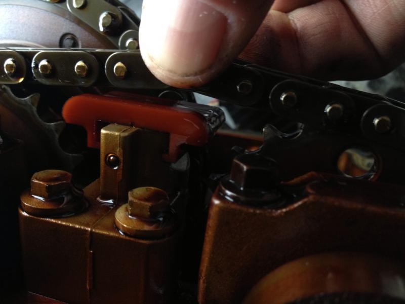

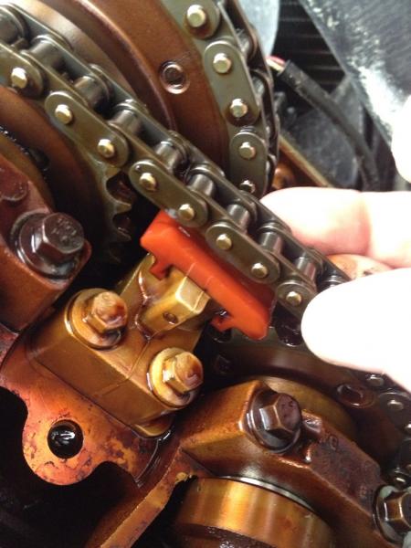

Yes i will sleep easy after this is done, Here are the pictures of how loose the top chain was on the RH Side, i just ordered the gasket set, and its about
$130 for both Tensioners RH & LH uppers but im still kind of shopping around because i heard i could order the 2000 Lincoln LS Tensioners and they are the same thing but cheaper?
either way i got to get them soon so i can get the job done, here are the pics!
And like you said Seconds away from disaster! As you see in the pics the top of the chain had no tension only the bottom had tension.

that looks like a metal tensioner, puzzle - this could be the first failure I've seen on here.
Can you confirm it is? if so is it extended, it doesn't look as if it is.

Thats what i thought too, i was expecting the Plastic spring tensioners in there,
That chain is always supposed to be under tension correct? do i pull up on the tensioner to see if it is fully up?
i dont know what generation tensioners are on here but my cars a 1998

That's a worrying picture as you've definately got a metal tensioner in there. It is spring-loaded so should be extended anyway. In the picture you show, it's the bottom part of the tensioner that's the moveable spring-loaded part, so you can't 'pull it up' on that side of the engine.
On the other bank of cylinders the spring-loaded moveable part faces upwards, so that side could be pulled up.
You need to take these tensioners out & see if they extend under their internal springs. If tbey do extend under their internal springs, then you need to check the oil supply to the tensioners & see if that is blocked. The oil supply feeds into a central hole in the tensioner base at the bottom, between the 2 bolt holes.
The other possibility is that the chains themselves have stretched beyone the limits that the tensioners can cope with. Either way, this kind of behaviour from metal tensioners is cause for concern-because you've definately got the metal tensioners in there.

Easy there. No need to panic.
As you already have the new tensioners coming, just replace them. This one you are showing is definitely collapsed (or not expanded). Could be many reasons why. My suspect are the bolts, but once you take the tensioners out, it will be clear.
The chains can not stretch as much as this, and the tensioner clearly looks like it's not expanded.
So,.....put the new ones in (with the correct bolts!), pull the pin, and see if they make the chain tight (I'm almost sure they will).
If they don't,......well it will be the time to rent some tools!

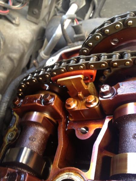

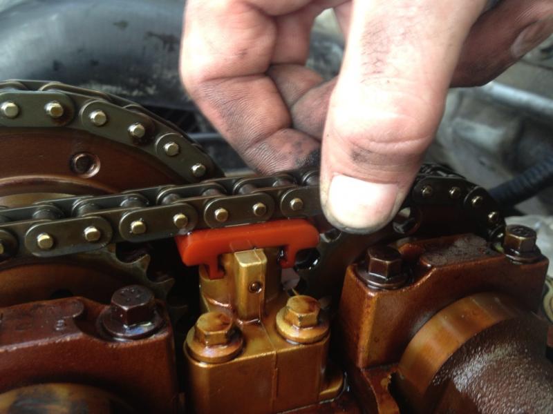

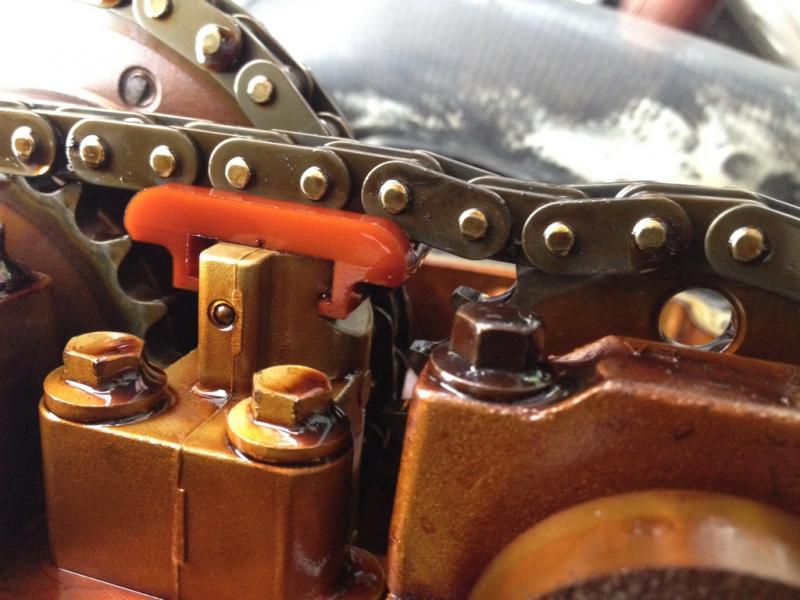

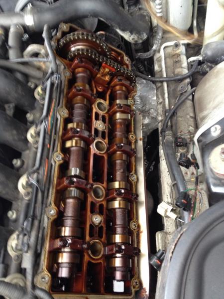

Talking UPDATE with GREAT NEWS
Finally Wobbled back into my room with my knee killing me also came an awesome feeling relief
i took off the valve cover on the (US) Driver side and tension was very tight on that one as pictured below. both top and bottom were under tenion.
As i rotated Engine Via Crank Pulley... The (US) Passenger side Tension did its job and started to apply Tension on the chain... Both top and bottom were under tension. IT'S ALIVE!!!
As for the (US) Driver side it started to give a little, Is this how the tensioners work?
Im very relieved to see that they are both working, i just got worried on how relaxed that chain was, i'm guessing it's due to the position of the cams?
