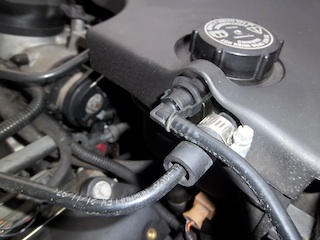

Had the same problem. Here's my butchered/hack work. If I remember in my case it was the fitting on the line that was damaged by the PO. They had JB weld wadded around the fitting in a ball.
Since I cleaned off the mess and did it this way so far 10,000 miles and no hint of a leak. (not here at least)

Well I tried using a thin 2-part epoxy and it did not hold even 1 minute... Ugh...
Please someone tell me where to order the connector from?

you get the whole line with the fitting manufactured to it. Or Sinisters fix looks clean too
