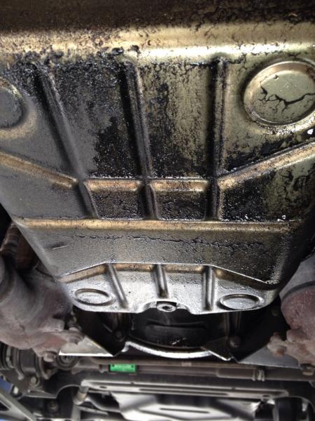

i did the transmission service and this is what i found in the pan ![Icon No](https://www.jaguarforums.com/forum/images/smilies/icon_no.gif)
![](https://www.jaguarforums.com/forum/attachments/xj-xj8-xjr-x308-27/30552-i-bought-my-first-jag-transmission-limp-mode-d5cfdd8d-4c0d-42f3-8df1-c910cd09f4bd-1210-000000aa3a2e1a82.jpg?dateline=1358485623)
![](https://www.jaguarforums.com/forum/attachments/xj-xj8-xjr-x308-27/30553-i-bought-my-first-jag-transmission-limp-mode-f7d762c7-7cbc-4453-ad9c-33787dfc9db0-1210-000000a2f724a430.jpg?dateline=1358485623)
Looked like a leak to me, coming from the front seal...

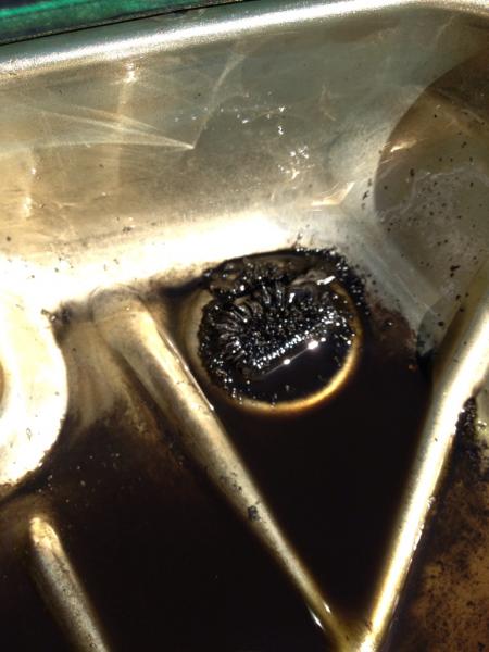

![](https://www.jaguarforums.com/forum/attachments/xj-xj8-xjr-x308-27/30554-i-bought-my-first-jag-transmission-limp-mode-0a43abba-43c3-4704-a442-0824a96cdf25-1210-000000aa35c1502d.jpg?dateline=1358485623)
![](https://www.jaguarforums.com/forum/attachments/xj-xj8-xjr-x308-27/30555-i-bought-my-first-jag-transmission-limp-mode-09362df7-dbc8-4406-babc-659d5913cd73-1210-000000aa318207ac.jpg?dateline=1358485623)
It was low on fluid and Magnets were covered in clutch material. the transmission had 123,000 and thats pretty good considering most of them (from what i hear) have pre-mature A-Drum failure.

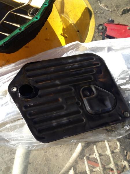

![](https://www.jaguarforums.com/forum/attachments/xj-xj8-xjr-x308-27/30556-i-bought-my-first-jag-transmission-limp-mode-c28eaab3-e53c-4533-a5d8-134512b8f01c-1210-000000aa2cdca778.jpg?dateline=1358485623)
Filter did all it could![Icon Naughty](https://www.jaguarforums.com/forum/images/smilies/icon_naughty.gif)
So i decided to put it all back together in hopes there was some clutch material left so i could at least have fun with the car over the weekend!!!!
But it did the same thing and popped into limp mode being the clutches were pretty much burnt toast!!! and got the Code of P1722![Icon Munching](https://www.jaguarforums.com/forum/images/smilies/icon_munching.gif)
