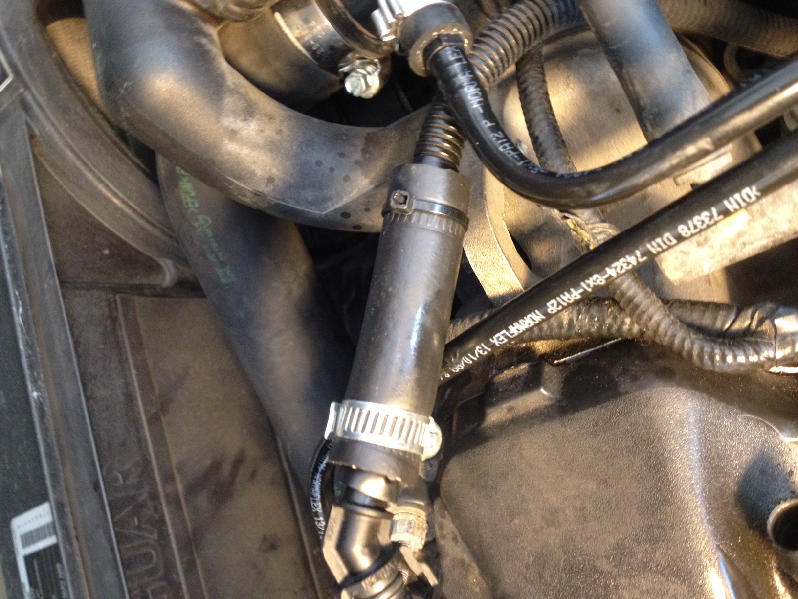

Okay, below is a picture of how I remedied the snapped corrugated line. I feel that it's airtight so hopefully, at least until I go back in next week to replace everything, it will work. I am not proud of the appearance, but it should work, right?
I am putting everything back together. I have a new gasket set, but since I am opening it again next week and the old gaskets look ok, I just lubricated them with a little Vaseline and reused them. I will put the new set on next week.
Thanks for telling me that the oil tube just pushes back in place. I was thinking I had to access the point where it goes in and reseal it, which did not seem doable!
If it doesn't idle funny or throw codes like mine did that should work. Be careful when replacing it. If it breaks somewhere between the cam cover and the TB, it could require supercharger removal to remove and install the new one.
wouldn't it be possible to push a new line through......might be a bit fiddly but with a fairly stiff piece of reinforced rubber tubing it could be pushed through and fished out at either end

You meant manifold not supercharger, right?
The tube is the part load breather hose (I think), but it doesn't look like mine (it quit raining). If it is air tight (spit on it), should be good to go. If leaking, as ebrewer noted, it won't idle. In fact, if the motor is a 99, you might need to clean the orifice (search for threads).
That is the exact process the shop used on mine. He just cautioned me that they just get so brittle you don't want it breaking somewhere in between. But it sounds like your aren't leaking like my quick fix was (rubber shrink fit tubing). I broke mine in the same location as yours. Turns out when they replaced it someone prior to me repaired it closer to the throttle body and it would have gone out soon anyway. So I didn't feel so stupid about breaking it.
