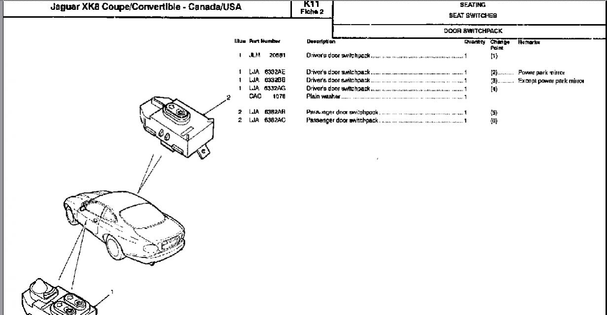

I have been trying to locate the part number for the very small bulbs that are located inside the window switch (I believe these are smaller than the ones that are in the dash). Dealer wanted to sell me the entire witch assembly. Any leads?

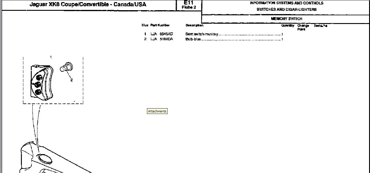

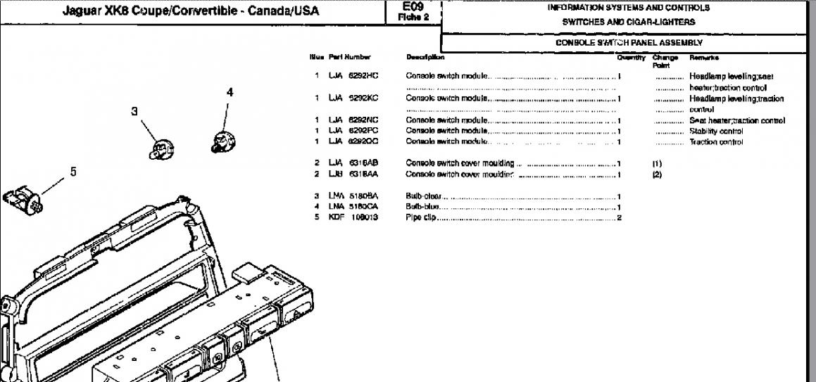

Here stu, its in the fiche #2, section E, page 09.
I took a screen shot for you
dneider, the parts catalog do not show any bulb replacement for the window switches in the door, they may be hardwired to the assembly. Not impossible to repair, another member in the xj area redid all his bulbs with LEDs, it just will take some electrical knowledge and soldering skill.
But, the memory switches do have a separate bulb.

That diagram confuses me, it gives me JLM21555,LNA5180CA & JLM21554 while I'm reading in this thread that its part # DBC6244 ?!
