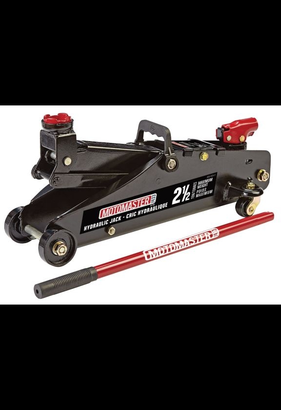

What would you lot recommend as a safe capacity for a trolley jack (also known as a floor jack or a garage jack)?
The one in the picture has a 2.5 ton capacity. I also have jack stands to support the car once it is raised. So, will a 2.5 ton jack safely do the trick?

Should be more than adequate, an x308 weighs in at around 4,000lb, but you are never lifting all of it at once, more likely 1,000-1,500lbs at a time when you lift to remove wheels. If you were to jack up the whole front or rear, I doubt you would be lifting much over 2,000lbs. A 2.5 ton (5,000lb) jack shouldn't have any problem.
I have two Pittsburgh 1.5 ton (3,000lb) racing jacks from Harbor Freight, I think they are on sale right now at the bargain price of $59.99!
And, of course it goes without saying that you should never go under a vehicle supported by a hydraulic jack, as you state, they are for lifting, and jack stands should be used in conjunction.

Thanks for taking the time to reply. I rather suspected the 2.5 ton jack would do the trick, and have a reasonable safety margin to boot. Still, it is best to check with the more experienced members of the forum.
I actually thought the XJ8 weighed in at about 5,000 lbs. It certainly 'feels' heavier.
I want the trolley jack so I don't have to risk having the floors collapse when using the jack from the trunk (boot). Besides, I am basically lazy so the trolley jack seems like the logical choice.
Thanks again for the quick reply.

Thanks for your concern about the jack height. You are quite correct to point out the fact that it looks too large for an XJ8. The picture, without any background to compare the jack to, does look a bit deceiving. When I go to get it, I will be measuring it to be doubly sure.

I have a pretty low jack, but mine lacks initial space for the handle to move due to the relative high pivot post.
In that respect the one on the coupon does probably better than the one in your first post.

So, I picked it up yesterday. It fits underneath with no trouble at all. Cad$114.99 all in. Not a bad deal.
