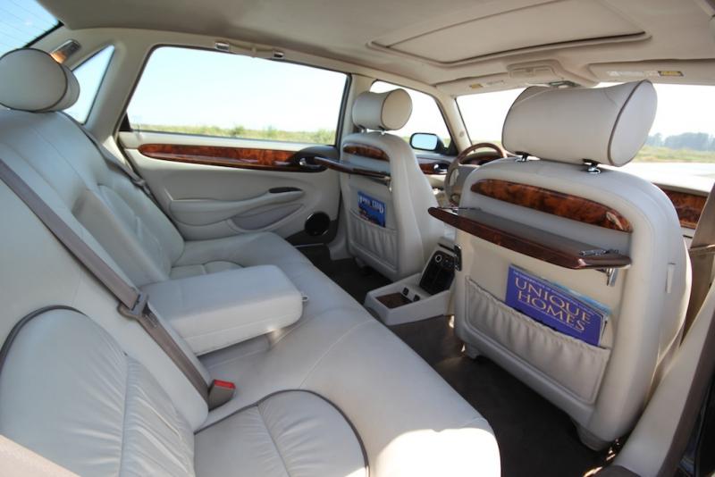

Hey Everybody!
With the cold weather the windows on my 2001 Jaguar XJ8 have been getting fogged up overnight, or after being parked for a short period of time (all windows). I had a crack in my front windshield but just had it replaced ($1,800), thinking it would fix the moisture issue. After having it replaced the guy told me he noticed moisture on the rear passenger floor.
Does anybody have any idea where this moisture may be coming from? Where could water be leaking in?
The carpet below the floor mat in the rear right passenger is where there is a bit moisture. It's not excessive, quite minor..but it needs to be fixed!! Any help would be greatly appreciated.![Icon Boat](https://www.jaguarforums.com/forum/images/smilies/icon_boat.gif)

it's a long shot but there's a series of bodyshell drain holes that have bungs glued into them in the floorpan, one of these bungs could have let water in, I think there's one in that area, you'll have to get underneath to check it out.
Not sure if the sunroof could also leak into this area if the drain port is blocked also, they're tucked up behind the front inner wheel arch cover - a straightened coat hanger might dislodge any blockage. What's the condition of the underside of the car like, it looks to be in great condition, but you never can tell about the underside...

The main reason why the floor gets wet, is the drain below the windshield. Many people aim to park under the trees in the hot weather, to protect the car and themselves from the sun. Trees ALWAYS drop sapplings, leaves, and everything else they have on them,.....add to that the dust, pollution, and gunk from the exhaust of the trucks you drive behind, and that drain is sometimes plugged solid. Water will find it's way to the ground, and in the case of the car, it will end up on the floor.
Taking the grill below the windshield off, will reveal the way the water is supposed to be drained to the ground. Open it up, and clean everything squeaky clean.
I also own newer S class Benz, and they are notorious for flooding the floor (and S.A.M. modules, which some "smart" kid designing this car, placed ON THE FLOOR!), if the drain is plugged.
Your problem can be easily solved by checking (and cleaning) all the drains. And you don't want to miss the sunroof drains (or you will be in a need of a new headliner)!

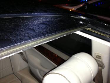

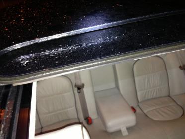

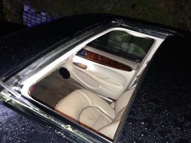

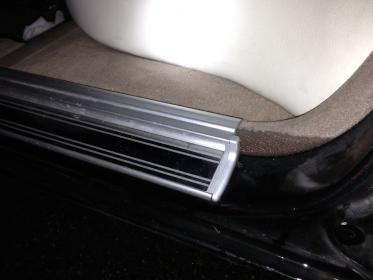

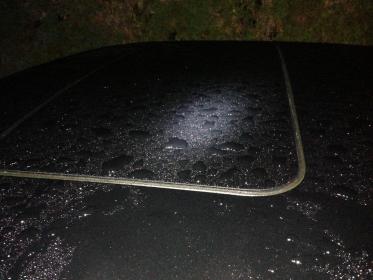

I've attached a bunch of photos of the sunroof. Could somebody point out exactly where the drains are?
Also you will notice there is moisture in & around the mechinisms of the sunroof. Is this normal or a red flag that it is leaking? The headliner is not affected at all. Just the rear carpets are experiencing wetness. **I don't know why they posted so small. If anybody would like to see the larger copies please let me know!

I didn't have a leak on mine, but my understanding is that the sunroof is NOT waterproof. It is designed to allow water through the seal and it drains out of the drain tubes. You can actually see sunlight through the seal if you look at it during the day. I'm guessing the drain tubes are either plugged, or disconnected somewhere. I'm sure someone else will chime in here and be of more help.
