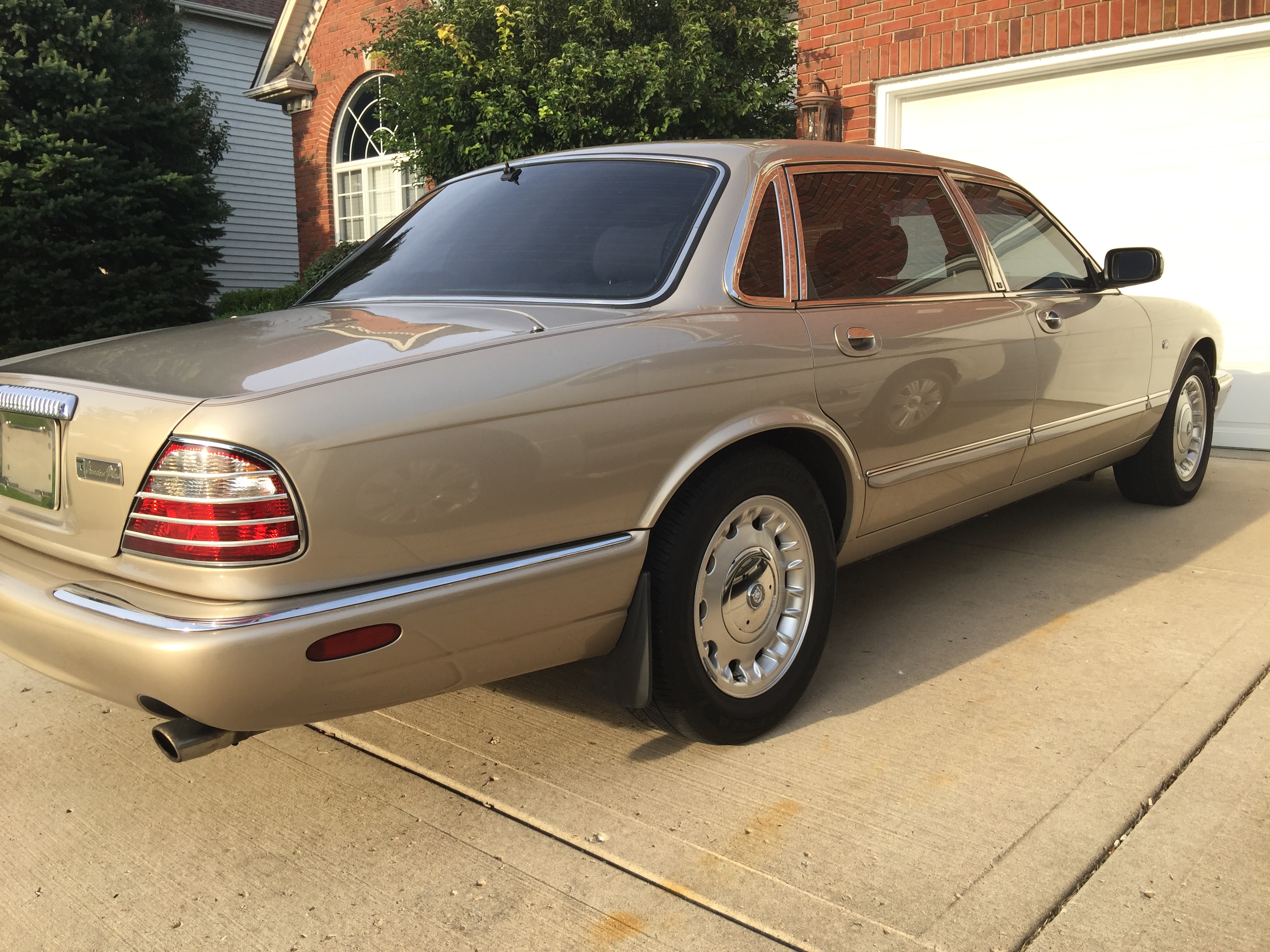

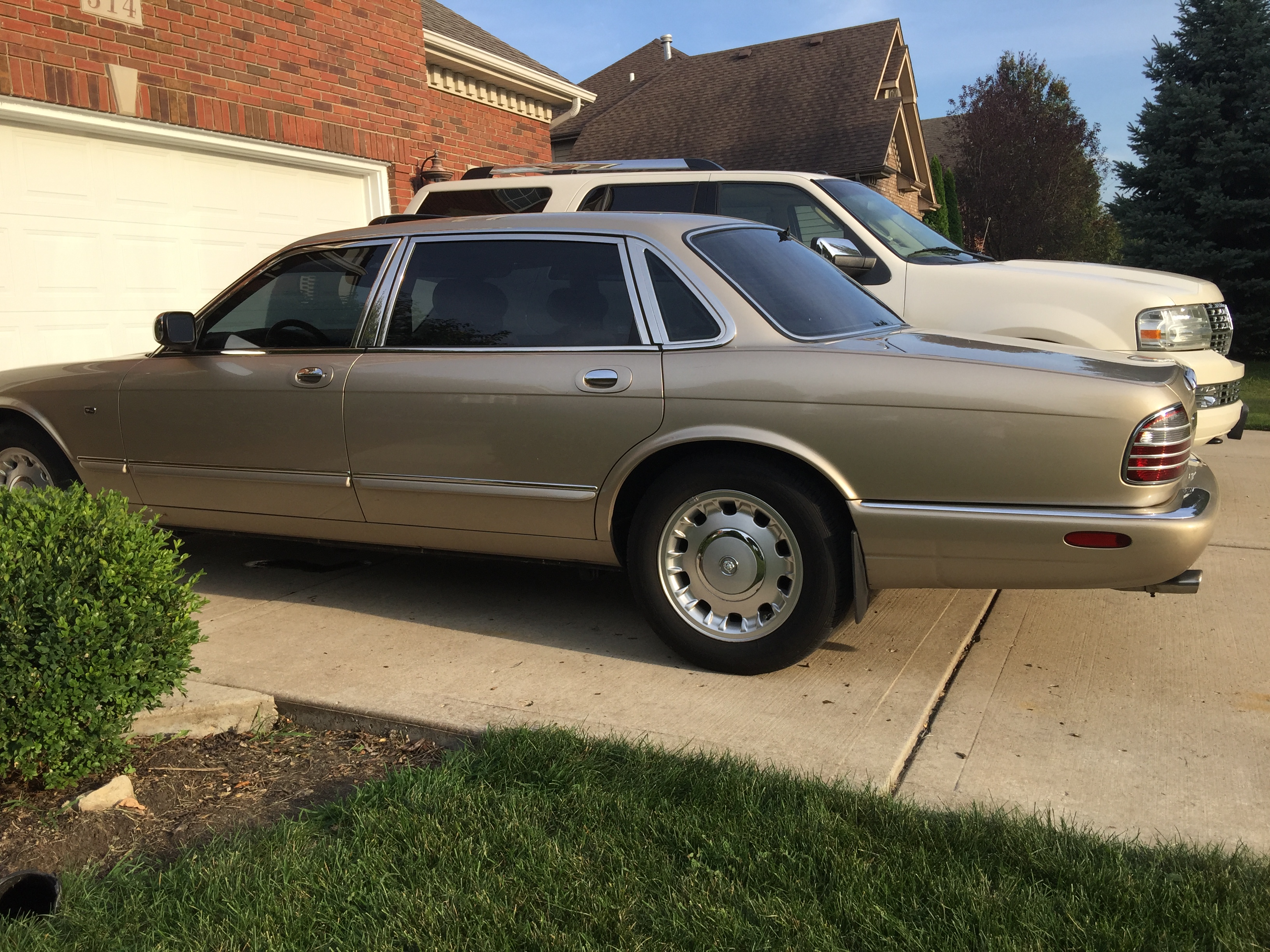

Purchased this 2000 model with 75k on it. In very nice condition.
A couple issues of coarse but nothing to big at the moment.
Issue 1 when I turn the signal on all the lights go it for a second. Guessing this is
Loose wiring in the switch but you guys can chime in.
Second I seem to have a small coolant leak as I can smell it. I have not located it yet though.
