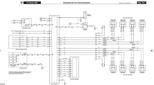

I'm in a huge crunch for time (sun is going down) and I can't figure out which pins are which so I can hook up the new head unit. I've already installed new speakers and ran new lines for them I just need to know which wires are Positive, Negitive, Car on Positive, and Antenna motor.

Here ya go:
From page 81 or 82 - http://www.captainjaguarscathouse.co...ec%20Guide.pdf

Thanks but I think thats the standard system. I guess i should have mentioned my car has the premium system. Either way the sun beat me and I had to bring out the flood lights. I was able to find the lines I needed with my multimeter but it took a while. Took the most time tracking down the antenna motor line and then once I found it I see that my stereo does not have that feature . New speakers, new speaker wires, new subs, new amp, new head unit, custom leather din for the new unit...... and it only took 12 hours. I'm happy though. I'll post pics tomorrow.
