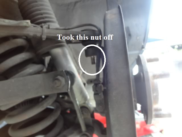

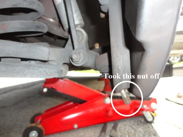

So the drivers side front wheel bearing is trashed and I need to get the axle off so I can take it to a shop and have them press in a new one. I took the only 3 nuts off that I can see holding the spindle on (see pics), what am I missing? Once the nuts are off should I be able to just swing the arms up and off or down and off? Thanks.

You have to remove the upper and lower balljoints nuts and the steering arm nut, use a press to take them out of the "vertical link" (the part holding the hub) and take it to a shop. They need a special tool to unbolt the ABS ring (a toothed ring) and then, using a press the procedure is easy as for any bearing change.The ABS ring tool cost a lot, might be 2-300 USD probably, so a Jaguar shop or a forum member might help you on this.

The ball joints are forced into their tapers in the spindle. Now that you have the nuts off you will need ball joint / tierod end splitters to seperate them. Or a big hammer (not recommended if you are reusing them). Protect the threads with and old nut if you are using a hammer

Thanks for the replies guys. Yesterday I wind up getting the top two off, as was suggested here, I put the nut on thethe ends and whacked with a 3 lb sledge, but the bottom was a PITA and I went and borrowed a ball joint separator, the same fork kind you show here. I honestly don't see how that would have worked without trashing the boots, but the lower boot was already tore up so I just removed it 1st. I didn't notice anything for the ABS in the way, do you mean the wire that I disconnected? Well, I'm going to call a few shops and hopefully this won't cost too much, I think I was quoted $280 for labor and all if still attached to the vehicle, I'm hoping to get this pressed in for under $50, I'll let you know.
