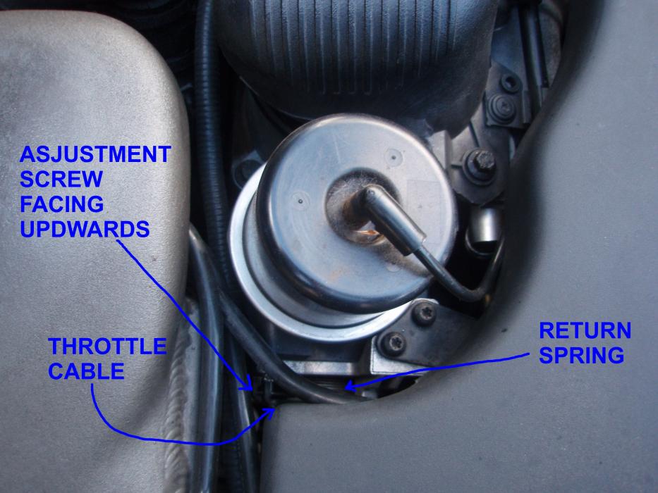

I have not replaced the throttle body, nor have I adjusted the idle, but I just walked out and looked. I hope these pictures make sense. I'm leaning over the Driver Side fender taking these. It's a North American car (Left Drive). First photo is for reference of where I'm looking, second shows as close up of the adjustment screw as I could get. It's done from the bottom up, so not sure how easy it's going to be, but that's the adjustment I saw.

Again, I have not done it on THIS car, but I can see that the screw pointed to moves the throttle position when resting. It's not the Cable Position, but the Throttle Idle Position. Cable adjustment is done on the cable itself.
I don't know for sure if that's the issue here, but it's easy to find out. Start the car and SOMEHOW get a screw/nut driver on that screw. Adjust it out and see if the idle lowers. If it does, then that's it. If it does not, keep track of how many turns you've moved it out and put it back in.
If it's too hard while running, turn it 1 turn out when engine off, then start it. If your RPMs are lower, then that's it.

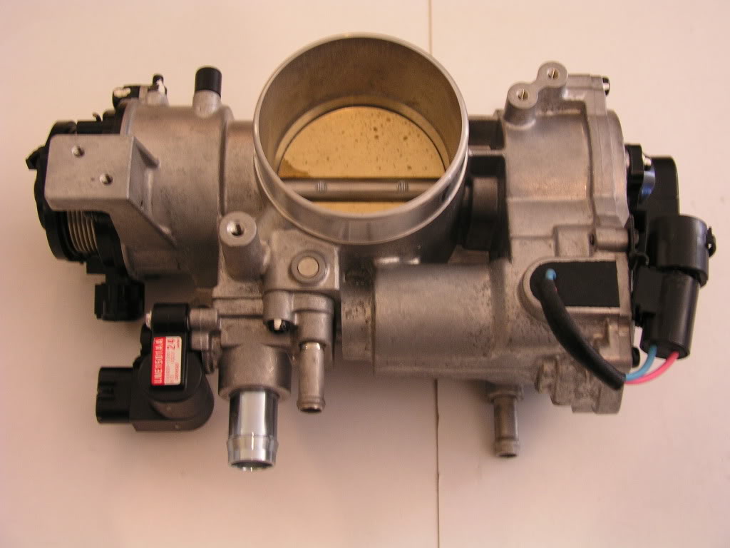

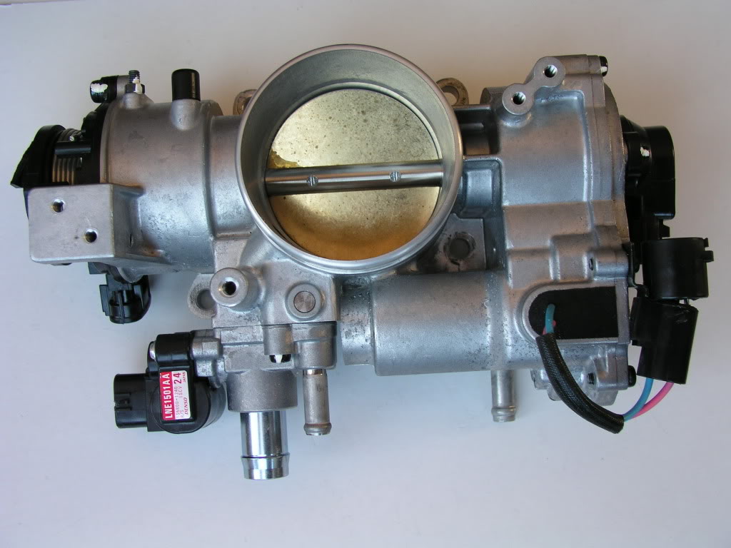

No such screw, my casting-series is 9E926 which is an air-assisted model, the best photos I can find of it online is:
(yes, I realize that the pictures are in the wrong angle to see the lack of adjustment screw, but I assure you it is not there)

Found a better shot: (note: plastic on mine is not cracked like this)

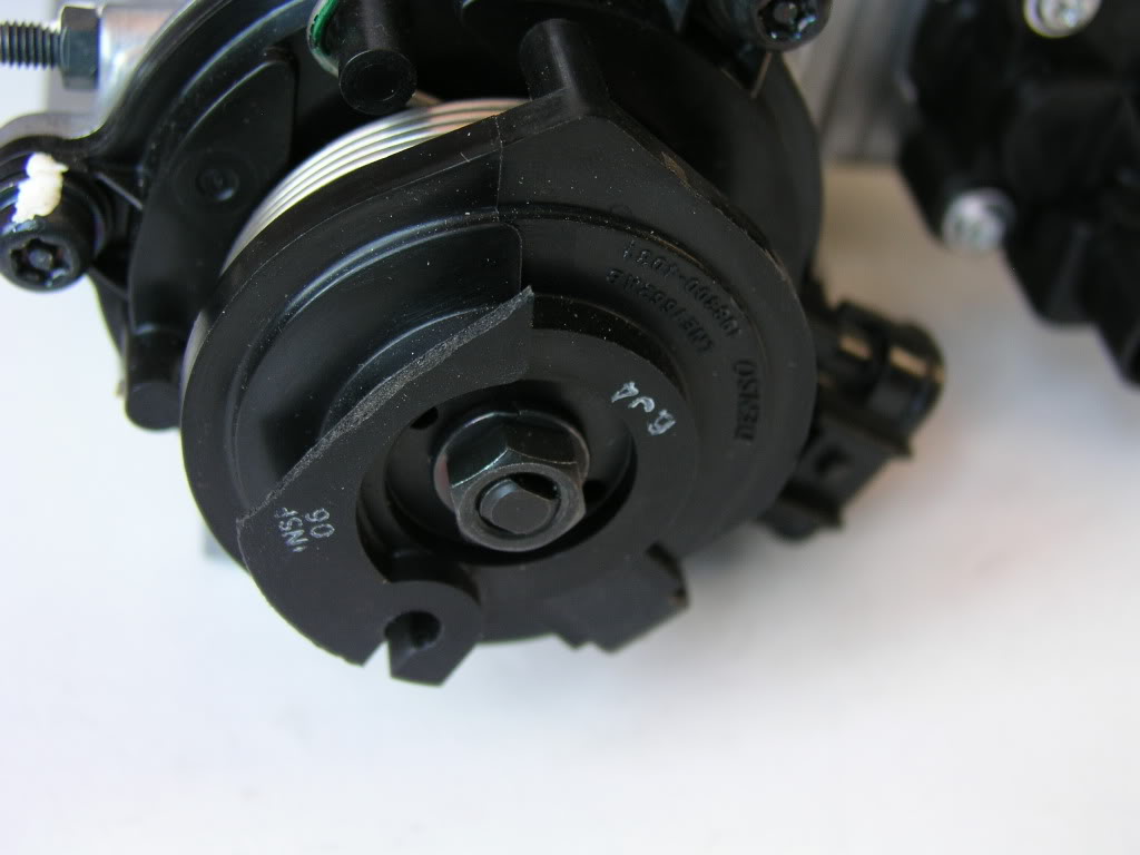

Funny, I've been searching for more pics of yours and I just found this photo also, along with others. I'm lost as to what to tell you. I'm sure one of the more experienced techs have done your throttle body before.
It seems strange though, as there's normally an adjustment somewhere. Especially, again, because your cable is lose where it might not have been before the change out.
I'll keep searching for an answer and post back if I find anything.

This is the newer style throttle body w/o a vacuum unit.
I have the same in my 99 XJ8.
I don't know how to adjust the idle rpms on this TB either.
The trottle position sensor can be adjusted (turned) so my guess is that this is the way to adjust idle rpms.
But be careful messing with the TPS!
When I tried to adjust (turn) the TPS on my XJ8 I got a "bang" in the drivetrain following a "transmission failure" message on my test drive.
So I set the TPS back to it's original position.
