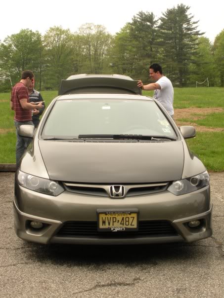

Not sure on the Navi but I can help with the xenons.
You can't just put the newer headlights onto your XJR, you would have to take out the projector from the newer lights and modify your current lights to make it work. With that said I dont recommend that as the VALEO projectors fitted to the newer XJ's are junk compared to other projectors.
Your best bang for the buck projector would be clear lensed Acura TSX projectors, they are relatively cheap at around $220 shipped and have a great cut-off, good width, and nice throw (distance).
You have to separate your headlights, remove the reflector, and modify it to mount the TSX projector, then line it up so the cutoff is straight. You would then have to get a shroud, trim and modify it to fit into your housing, then close everything up and mount. I have done a total of 5 HID Retrofits, I'll post pictures for you shortly.

These pics are from my 2008 Civic, but the concept is the same for all cars. If you are interest and have the money, I can possibly make a set for you.
