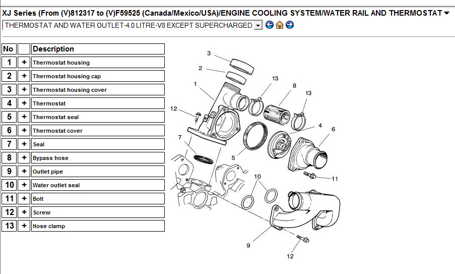

Be very careful about overheating the V8 - it can seriously damage the engine very quickly. You can't rely on the Temperature Gauge because it doesn't move from Normal until the engine has overheated. Plenty of threads on the forum about this.
"moister smoke (when water is more than 100degrees by Celsius....." is called "Steam".
If you haven't got a split in any of the cooling hoses to explain the coolant loss, you may have a stuck Thermostat (see item 4) or failed Water Pump. Both of these are regular issues.
As it started and ran at Pep Boys after it had cooled down, you have probably avoided damage. Post here again when they tell you want they think is the cause.
Attached Thumbnails Overheated xj8 - 2001 or not? and what to do?-xj8-thermostat.jpg
