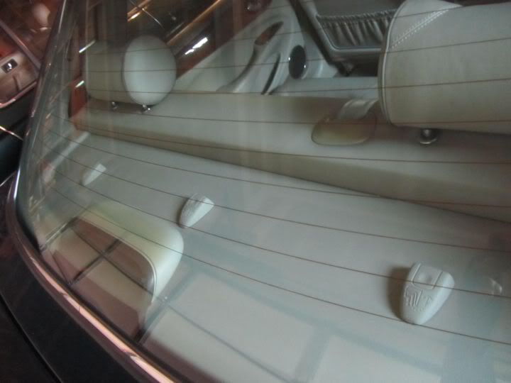

Here are photos, illustrations and instruction on Child Restraint Anchorage for XJ 2001 to 2003 XJ model series:
Photos:
Note: push in and lift up on center front plastic piece (tab shown on left in last photo).
Illustration:
Instruction:
Photos are our 2001 XJ8, illustration and instruction are scans of pages from 2001 XJ series Driver Handbook.

Well I have good news that I found a gracobaby snugride install you tube video:
and I found out that you should not use Top Tether Anchor for a rear facing car seat (per this online article on the car saftey.org website):
http://www.car-safety.org/latch.html
It has a photo of a front facing car seat with the latched Tethered belt attached to the Top Tether Anchor on the rear parcel shelf.
Looks like you will have to use the rear seat belt in your XJ8 for your rear facing car seat instead of the tethered brackets located on the rear parcel shelf as shown in you tube video.
Jim Lombardi

Thank you Jim. Ended up going that way. With the belt method the base is a little looser than the latch system in my other cars, but I will give it a try as it seems to get tighter when the car is started. Plus, I always feel safer in my steel tank of a Jag
