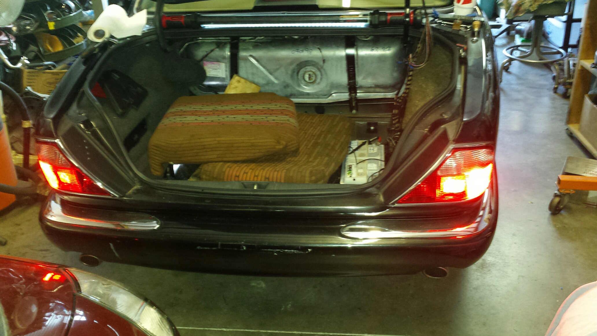

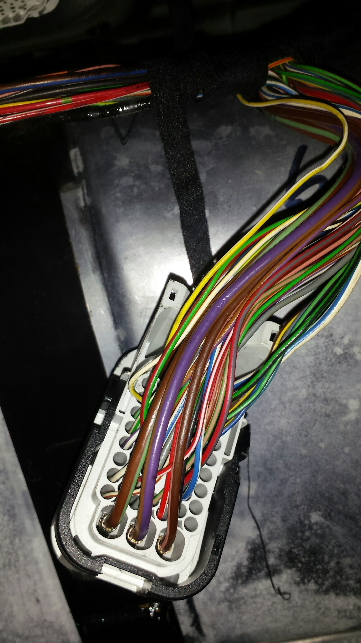

Have a strange problem with my 99 XJ...my radio antenna (extend-retract), CD changer, trunk interior lights, electric trunk unlatch and brake lights (tail) are not working. Don't see a lot of connection to these issues (maybe CD and antenna). Located large connector in trunk that I believe is the feed for the rear of car, but can't find any electrical drawings to check it by.
Pictures of the connector is posted...as to the brake lights, the tail lights come on with ignition on and do not change when the brake pedal is pressed (the upper brake light works). All fuses and relays seem to be ok
Any help would be greatly appreciated.

BT4. You need to separate each circuit.
