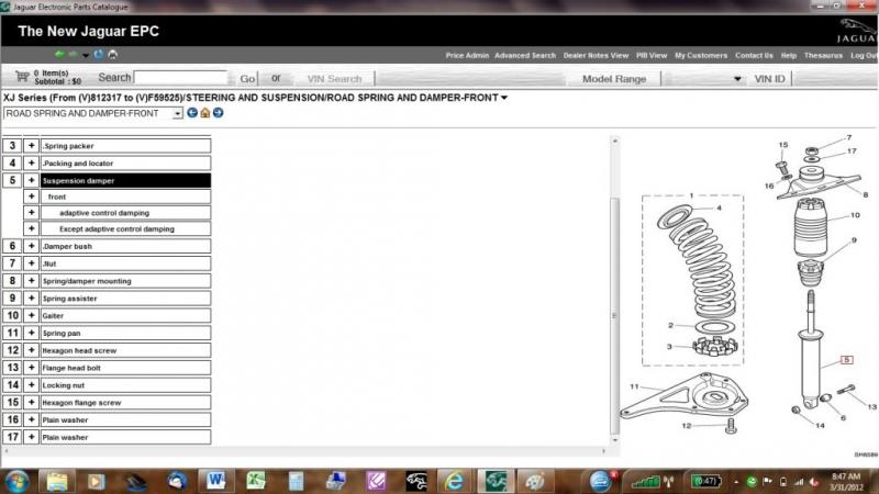

Here is a screenshot of the front shock & spring parts listing & diagram (from Jaguar Electronic Parts Catalog). The diagram should shed some light on what are the component parts and how they are assembled.
Item# 5 contains the following information
XJ (X308) Front Shocks – (non CATS ) listed as “Suspension damper – front - Except adaptive control damping”
comfort suspension Part number MND2140AD
sport suspension MND2140CD
Jim Lombardi
Jim Lombardi

The prices are usually charged at a higher rate on the service order quotes by Jaguar Dealership Service department.
If you had front Cats shocks, the parts costs would be at least $900 (then you have to add the labor changes on top of that) at the Jaguar Dealership.
Jim Lombardi
But, if they're there, and the car is programmed to use them, then there would be 'Suspensions Fault' displayed if not plugged in? Unless it can be disabled via IDS or before it left Jaguar, in which case it'd be pointless to supply it ready, and not fit them, if you understand.
The other option, if the car was originally fitted with them, then the owner replaced them with standard shocks due to the price, I've seen this a few times on here.
Jim's right,
Jim Lombardi
Fred sez: Jim is RIGHT ON THE MONEY. i was thinking CATS, because
i couldn't conceive that cost quote on "conventional" shocks. WRONG.
i have seen the Bilstein Sport shocks (non-cats) for $240-ish... and i
actually consider that to be reasonable.
at least now, thanks to the knowledge base here on the board, i know
what i'm gonna do. I'm gonna buy those Bilsteins.
Fred
Jim Lombardi
Fred
