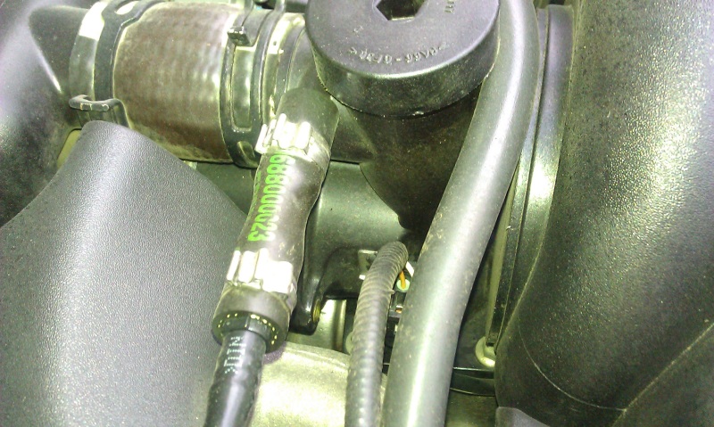

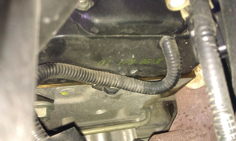

I checked the car now and something came funny to me.
First, i have this cold engine starting sound. It is after night alone at 3°C:
http://s153004283.online.de/~s13347/jag/audio0051.mp3
Does it sound good?

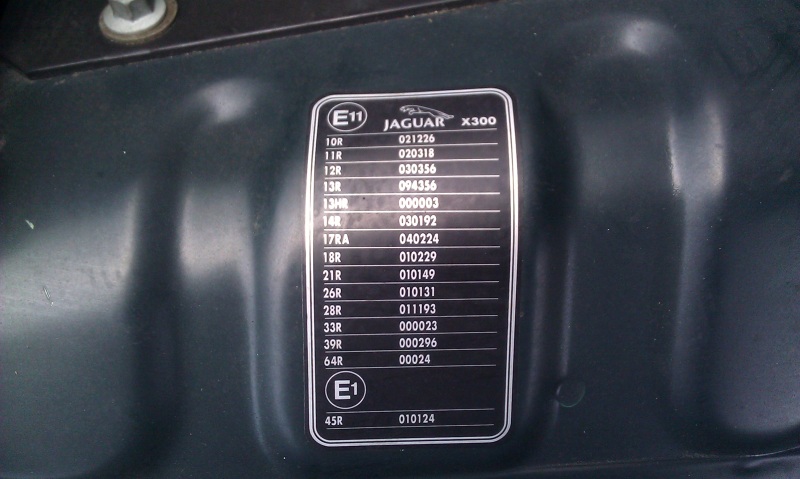

I didnt found engine number but found this:
Also sticker on my body says x300, not x308
is this the thermostat housing, is it plastic?
Does it sound good?

I don't hear any noise that is related to loose timing chain, but the valve, and ignition coil's cover's seal is leaking a little. I think it's no the time to worry about yet, just not perfect.
I can't say anything about the thermostat house, I have R's, not NA, and I'm not a long time experienced guy with Jaguars.
