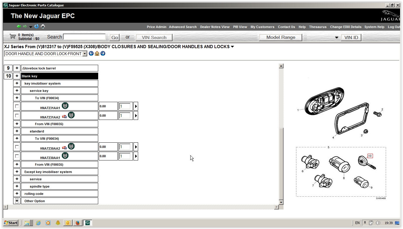

Peter, as we discussed on the phone, here are the parts for the "lock set" and blank keys:
Stolen keys X308 1999 - Reprogrammed - RESOLVED-screen-shot-03-20-16-07.39-pm.jpg Stolen keys X308 1999 - Reprogrammed - RESOLVED-screen-shot-03-20-16-07.39-pm-001.jpg
The blank key is about £50, the lock set £330, in the UK, god knows what the local price would be.
