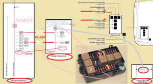

Hi Gents
Itīs about my XJR 2001.
I have replaced the lower and upper pully (bigger/smaller) for more power and switched to an extra big supercharger cooler. During that, I realised that the supercharger water system is the same as that from the engine.
Is that silly ?!, so the supercharger water system will allways have the same temperature as the engine water system so power is allways degraded because of that.
I also have changed the catalytic converter from original to 200 cells, I welded that by my own and one side will not line up with the connector going to the rear. There is a very small slit between the gasket you canīt hear it but I can smell it.
Sorry for the big intro... :-) now the problem: When I accelerate at full throttle the engine stutters.
First I thought it might have something to do with the exhaust issue, but now I think it has somehting to do with fuel pump. Is it possible, that after the pully change it is also necesary to upgrade to a stronger fuel pump ?
As far as I know the XJR has 2 fuel pumps. Which one should I change ?
So...what do you guys think ?
Thanks
Frank

The # 2 fuel pump relay is next to the # 1 and can be hot wired by putting a jumper ( with a knife connector so no arc damage to the sockets ) in the 2 larger of the 4 relay wire sockets . Remove the # 1 relay and listen for the # 2 pump as the power source it hot at all times and there is a fuse after the relay before the connector .
There is a command on control out of the ECU we can look at after you do this to see if it resolves your spot of stumble under the bonnet .
You may have 2 under performing relays that can be swapped out from elsewhere as a least intrusive try .
Yes on Highhorse's recommendation below on fuel filter change .
Attached Thumbnails stuttering on acceleration / full throttle-x308-fuel-fuses-untitled.png   stuttering on acceleration / full throttle-x308-fuel-pumps-ntitled.png
