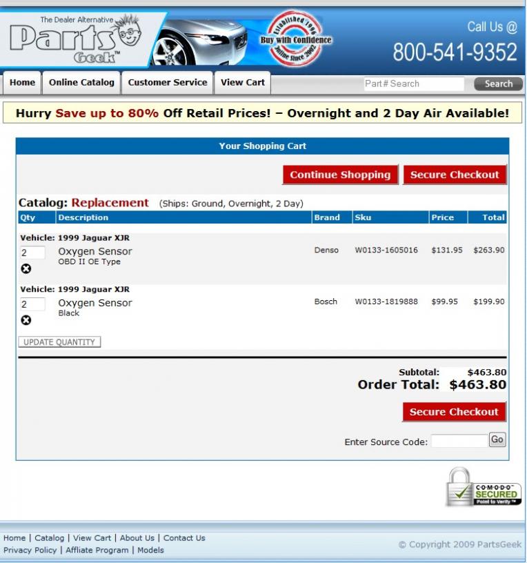

I'm not sure if you are refering to just parts or parts & labor, but just wanted to drop this image if your price was just parts. I hate spending full price if not necessary.
I realize you may not be changing these, but wanted to offer an alternative price if you do.
