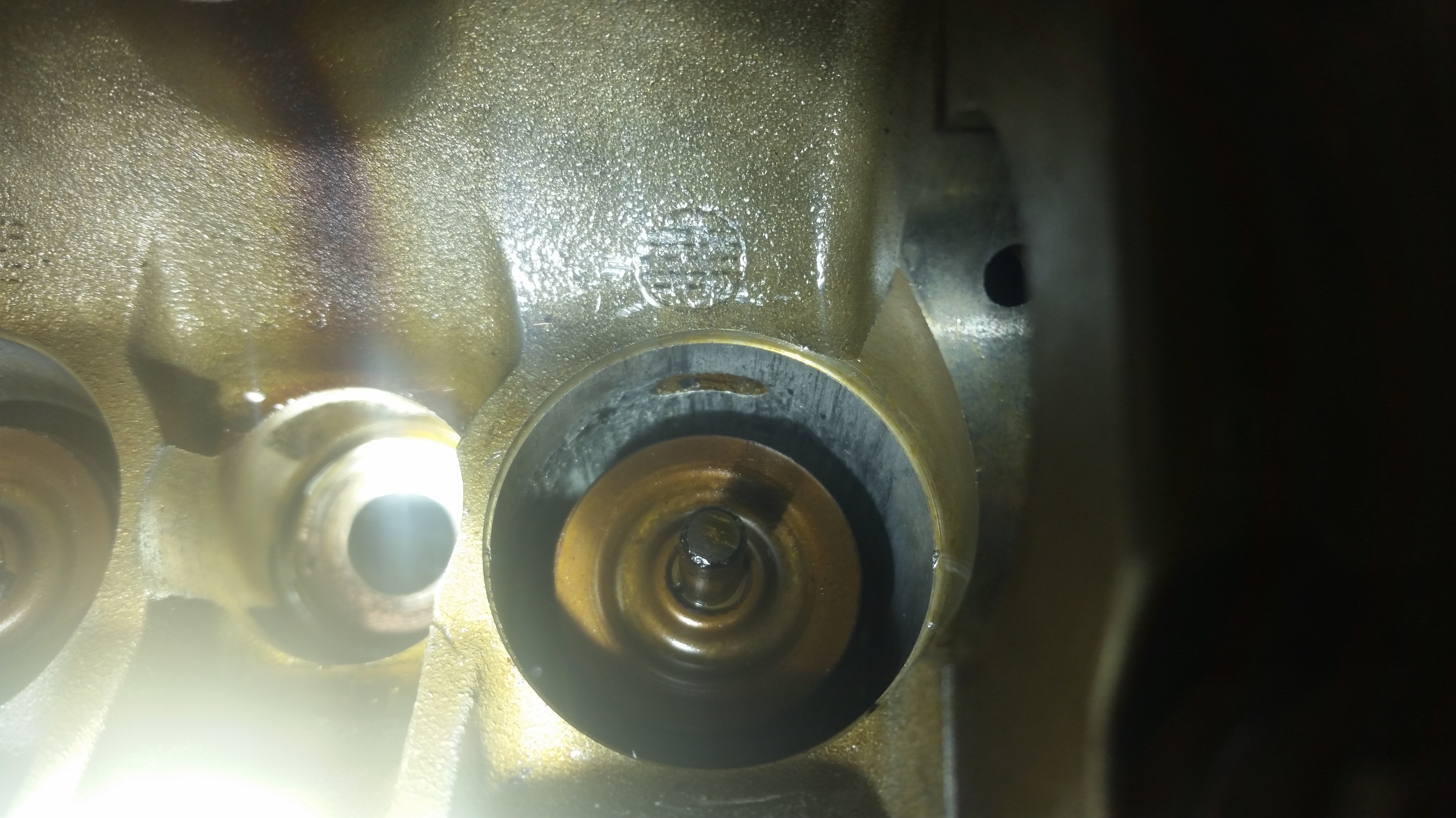

Don't mean to scare you but your engine will look like the photo below.
To do a valve job you will have to remove the heads. The timing cover will needed to be removed and the cams will need to come off because the head bolts are under the cams.
After you get the head off you will take the cam buckets off. Then you'll need to use a valve spring compress to compress the springs so you can remove the two retainers. When the retainers are off and the compressor is removed the springs will come out and the valve can be removed. The second photo shows the valve springs still in the head.
I think if you have zero compression on a cylinder you most likely dropped a valve seat. I have a head at my shop with the dropped valve seats and I can post a photo of it tomorrow.
If you check the clearances it will help us dianose the problem. If you have any other questions contact me tomorrow.
Attached Thumbnails Things don't look good. Coolant leak, overheated, misfires and knock-20160704_114859.jpg   Things don't look good. Coolant leak, overheated, misfires and knock-20160710_162257.jpg

It looks to me like you proably have 3 dropped valve seats. You will have to take the heads to a machine shop to have them replace the seats and whill they have the heads have them do a valve job and set your clearances.
To remove the heads I didn't remove the exhaust manifolds. I removed them with the heads. Just take the four nuts off at the exhaust manifold and catylitic converter. Soak them with PB blaster because they usally have a little rust.
