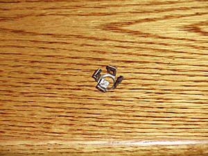

Thanks for the reply AZjag1999! And, yes, there are "clips" that hold the lines to the tank. Virtually every (not going to guarantee you 100%) fuel line connection has a method of retaining the fuel line to a filter, carburetor, tank, etc., whether it's a threaded attachment or a quick disconnect. The quick disconnect uses an internal clip to hold the fuel line at the point of the flare. As you described in your reply, there is a tool (we have several sets at the shop to accommodate standard and metric sizes), and it's the retaining clip that you are pressing against in order to release the line from the point of entry in the tank.
In the attached pictures (and, not very good pictures at that) you can see one of the retaining clips on the left. The right side of the clip shows what it SHOULD look like, and the left side of the clip reflects how it has been damaged. Due to low fuel pressure, we set out to change the fuel pump. When we released the lines, the return line clip popped out...likely because it was damaged at the point someone previously had changed the gas tank. The picture on the right is an overhead shot of the same damaged clip.
So, I'm on a quest to find some replacement clips. Since the tank is out of the car now, I would like to find both of the clips.
I appreciate any help, so thanks again!!
don
Attached Thumbnails Vanden Plas Parts-dsc06340.jpg   Vanden Plas Parts-dsc06342.jpg

Thanks for the reply AZjag1999! What you are describing is a tool that is used to release the retaining clips. Virtually every (not going to say 100%, but it's logical) fuel line has some kind of retaining method to secure it to a carburetor, filter, fuel tank, etc. In the case of many systems it's the retaining clip that you are releasing with the disconnect tools. The retaining clip snaps on to the fuel line flare and you have to release the retaining clip in order to pull the fuel line out of the (in our case) fuel tank.
Apparently someone previously changed the gas tank. In that endeavor, one of the clips was damage. While we didn't have any leaks, at this point we needed to pull the tank in order to change the fuel pump. (Low fuel pressure was causing running/drivability problems.) When we pulled the return line, unfortunately the damaged clip came out with it.
In the pictures, attached here, on the left you can see the clip I'm referring to. On the right side you can see the shape it SHOULD be in, and on the left you can see how the clip is distorted. The picture on the right is just an overhead shot to give you an idea as to the relative shape/size of this clip.
I would really like to find a set and replace the retaining clips on both the supply line and the return line.
I appreciate any help and with to thank you again for your reply!
don

Those lines go into the tank on the flat side (which goes toward the back seat), bottom center. You'll see 2 recesses where the lines clip in. I don't exactly recall, but I believe there was a tank design change from either 98/99 or 99/00.

Here's a drawn schematic, this is shown just above the differential.
...and here's a direct shot I believe of exactly what your in search of...

I believe the part is called a STUFFER PIN (#7 in the parts diagram) (EBC9606).

Highhorse and motorcarman have hit upon what I'm looking for. As mentioned, we have the tank out of the car, just need the new "Stuffer Pins"!!
Thanks, for everyone's help. Now, the search continues for the new stuffer pins!!

As usual, Bob pulls it off the top of the 'ol noggin'.... https://www.terrysjag.com/product/EBC9606.html

Yes, yes he did! And not only that, the applicable parts are on order, as we speak!!
