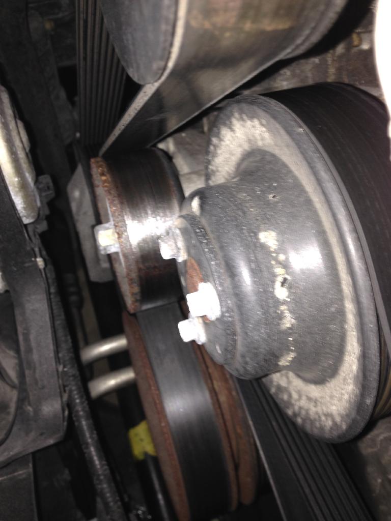

Hello all!
Well tonight I started the Jag and after a few minutes ended up with an orange puddle under the car.
After opening the hood it looks like it's the water pump as none of the hoses are leaking and well, it's got 85k miles on it I have owned it since '06 with 43k miles and never changed it and for some time have smelled coolant but never saw it.
Well now it's on my belt and the front of the engine. Since there isn't a close Jag dealer and I need to fix it ASAP, where does everyone recommend where I buy a water pump?
Too in the attached pic do I have the old belt tensioner system or the updated? Also is my thermostat housing what I believe it to be the metal one. I figured I would replace the water pump, the thermostat, belt and bearings for the tensioner.
Any recommendations would be appreciated.
One last thing, coolant, where to get, what kind and bleeding recommendations.

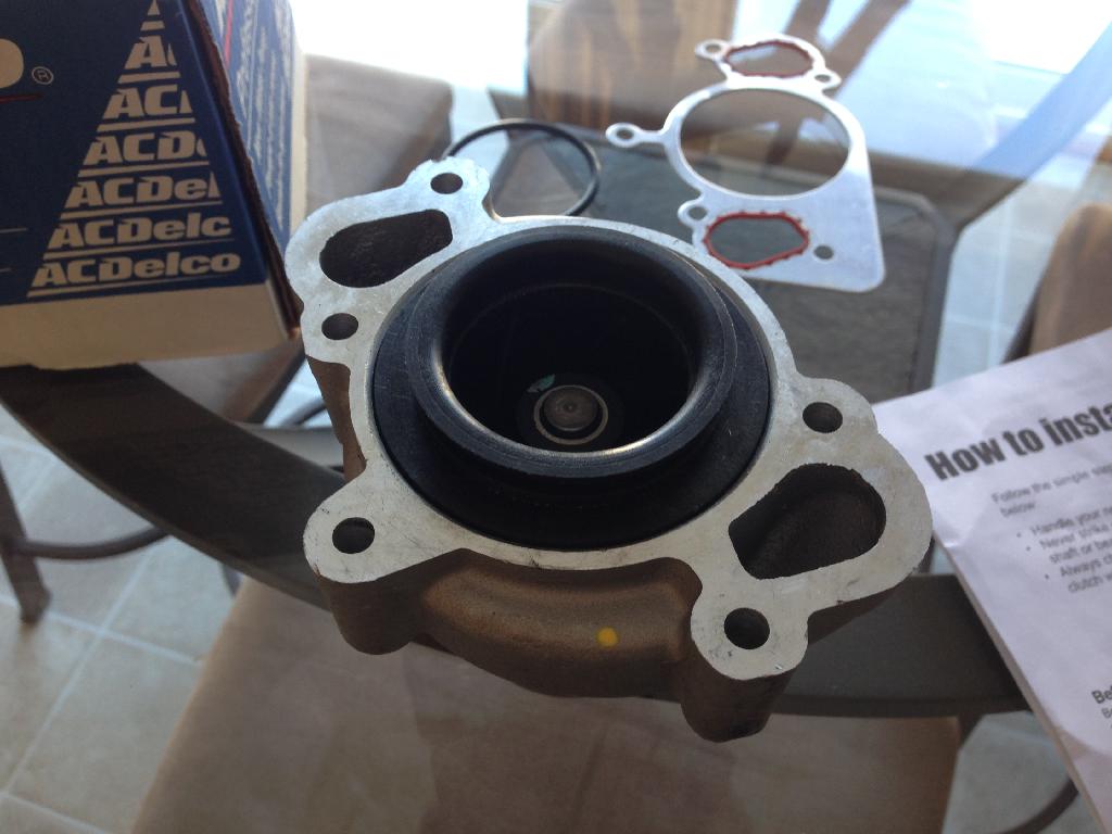

Ok, my water pump arrived, it looks like the older design as all the ones I have seen are flat w a paper gasket. It does not have the metal impeller, it's plastic. It is made in the USA.
First, is this design ok or should I be sending back?
Next it looks like one of the ports is blocked. Is this normal? I don't know as I have not removed the old one yet.
Thanks!!

Asking if the airtex has a white plastic impeller, the metal replacements are not the best for a number of reasons, the black impeller is from the failure days, send it back.
I'm running AJ27S pumps, white plastic impeller, one 300k miles, 150k miles and 2k miles
AJ26 1997-99 (US, 98-00) Had failures with the black plastic impeller pump, bits fell off and blocked waterways, causing an over head event leading to valve seat damage, TSB's covered replacement to the later white impeller from the AJ27 engines.
Alloy 'impeller' replacements have little fins that cause cavitation, they're not a fluid dynamically designed replacement, like Jaguar's.

Thank you Sean!
I ordered the Airtex, it has the white impeller.

There has been way to much paranoia about plastic impellors.
Granted, yes, the original fitment black plastic impellors did give trouble on SOME engines and far too may were replaced cart blanque.
The white impellors are the same being used on the latest pumps for X350's
The metal impellor pumps are not the answer and are not as efficient or as well designed as the white plastic impellor pumps.
They seem to suffer from cavitation erosion whereas the white plastic ones don't.

96JV-8501-CA, CB, CC or CD, replace the coolant pump.
(Illustration 1).
3. Install the coolant pump pulley. (See Workshop Manual, JTIS
CD ROM, section: 303-03, SRO 26.50.05).
Note: For all affected model years refer to JTIS procedure for
1998 MY V8 XJ and XK series vehicles.
The procedure is not listed under any other model year.
VIN 028001-on (XK series) and VIN 843501-on (V8 XJ series)
It is not necessary to remove the coolant pump pulley for
inspection unless there is a genuine coolant pump concern.
Do not replace these coolant pumps as a matter of Policy.
LEAKAGE
Note: Do not assume that staining around the exterior of the coolant
pump body is due to a coolant pump leak. Check the cooling system
joints, for leaks, in the area above the coolant pump. For any cooling
system issues follow the workshop procedure as detailed in JTIS for
checking/diagnosing the cooling system.
On replacement engines, it is not necessary to replace the coolant…..
……pump, unless the coolant pump being transferred has one of the part
numbers listed above.
IDENTIFYING COOLANT PUMP IMPELLER MATERIAL
Note: Do not automatically assume that a black impeller is made of
Nylon 66.
The latest pumps use
White Poly Phenyl Suphide fitted from V8 Vin range 843501 to F59525
Looks like the latest version of the Jaguar Water Pump with the white impeller is made by Airtex part number AW4124 .
According to Airtex webpage (show me the parts) automobile lookup:
showmetheparts - Airtex Water Pumps
Airtex AW4124 covers 1998 -2009 XJ and 1997 - 2009 XK
Here is a JPEG I created from Airtex webpage with closeup of the AW4124 pump showing the white impeller:
The AW4124 is the only water pump that Airtex sells for the 1998 - 2009 XJ and the 1997 - 2009 XK.
The Airtex water pump prices:
Ebay - $51.98 free shipping
Airtex AW4124 Engine Water Pump | eBay
Rock Auto - $45.99 plus shipping (about $9.00) - weblink - select 2001 Jaguar 4.0L V8, then Cooling System, then Water Pump:
RockAuto Parts Catalog
Amazon - $58.88 free shipping
Ebay - Christopher Foreign Car Parts - $79.99 plus shipping $11.25
Jaguar V8 Water Pump 1997 2007 New Improved Style | eBay
SNB Barratt USA $85.75 less 10% plus shipping (????)
SNG Barratt - The Ultimate Jaguar Parts Specialist
