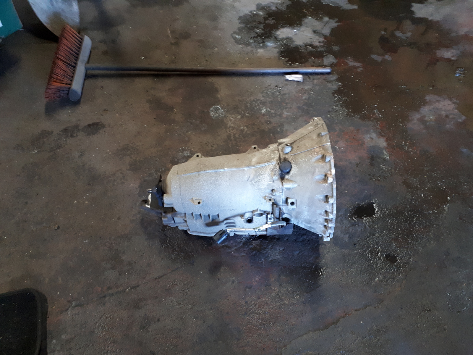

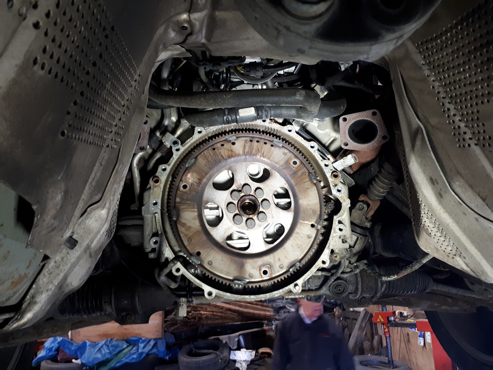

I inherited my fathers XJR after the gearbox chewed up its internals, so i did the only sensible thing and bought another one as a parts car. Spent the last day and half swapping out the gearbox so its back in business
Attached Thumbnails What did you do to your X308 Today?-20171017_161446.jpg   What did you do to your X308 Today?-20171017_161501.jpg

Error , do the supercharger and normally aspirated engine versions share the same transmission in the X308 series ?

No, the supercharged engine uses a Mercedes Benz transmission.
This one had an unusual failure where it locked up and broke tooth on a sun gear, which then did some more crunchy crunchy and made metallic soup.
