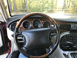

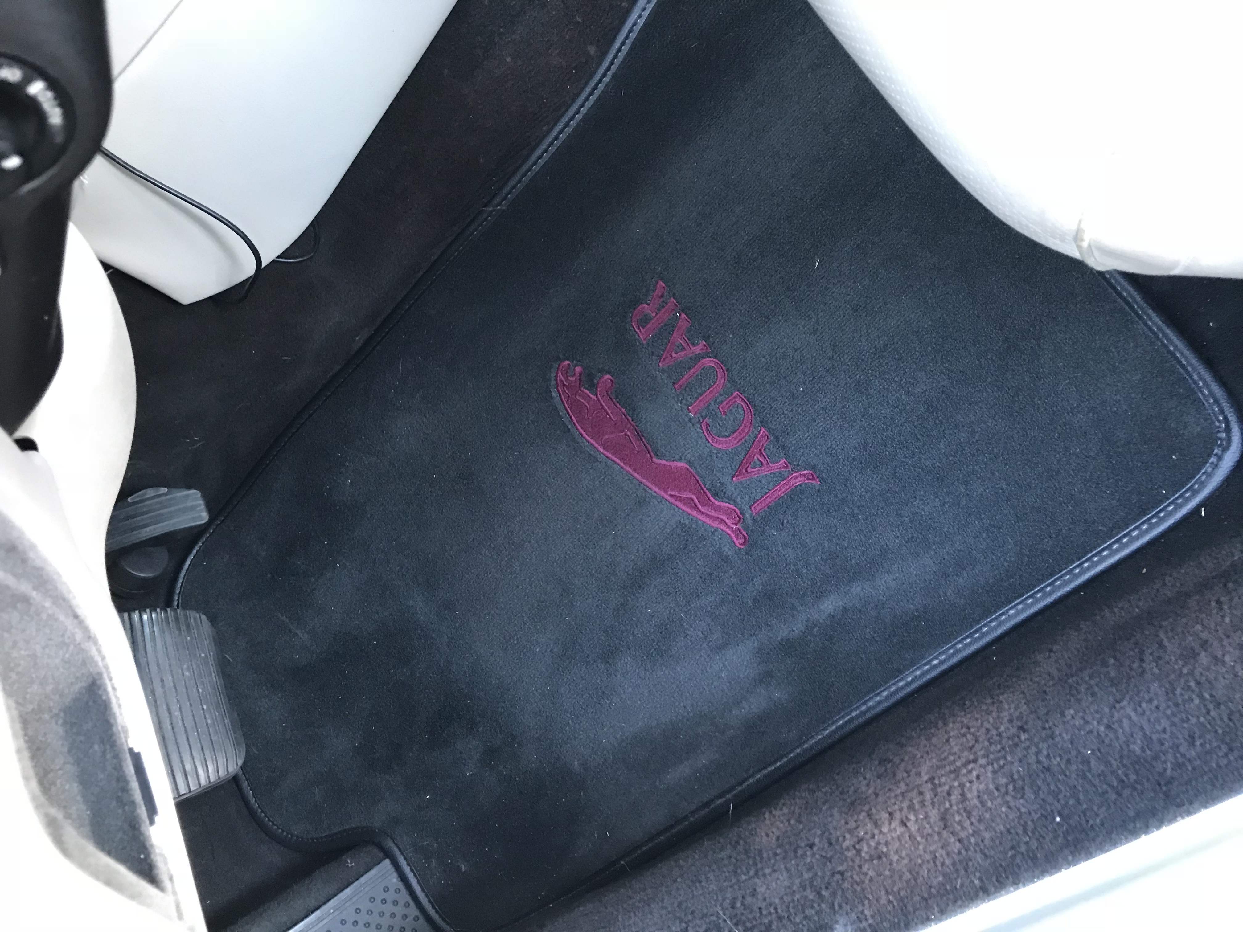

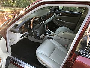

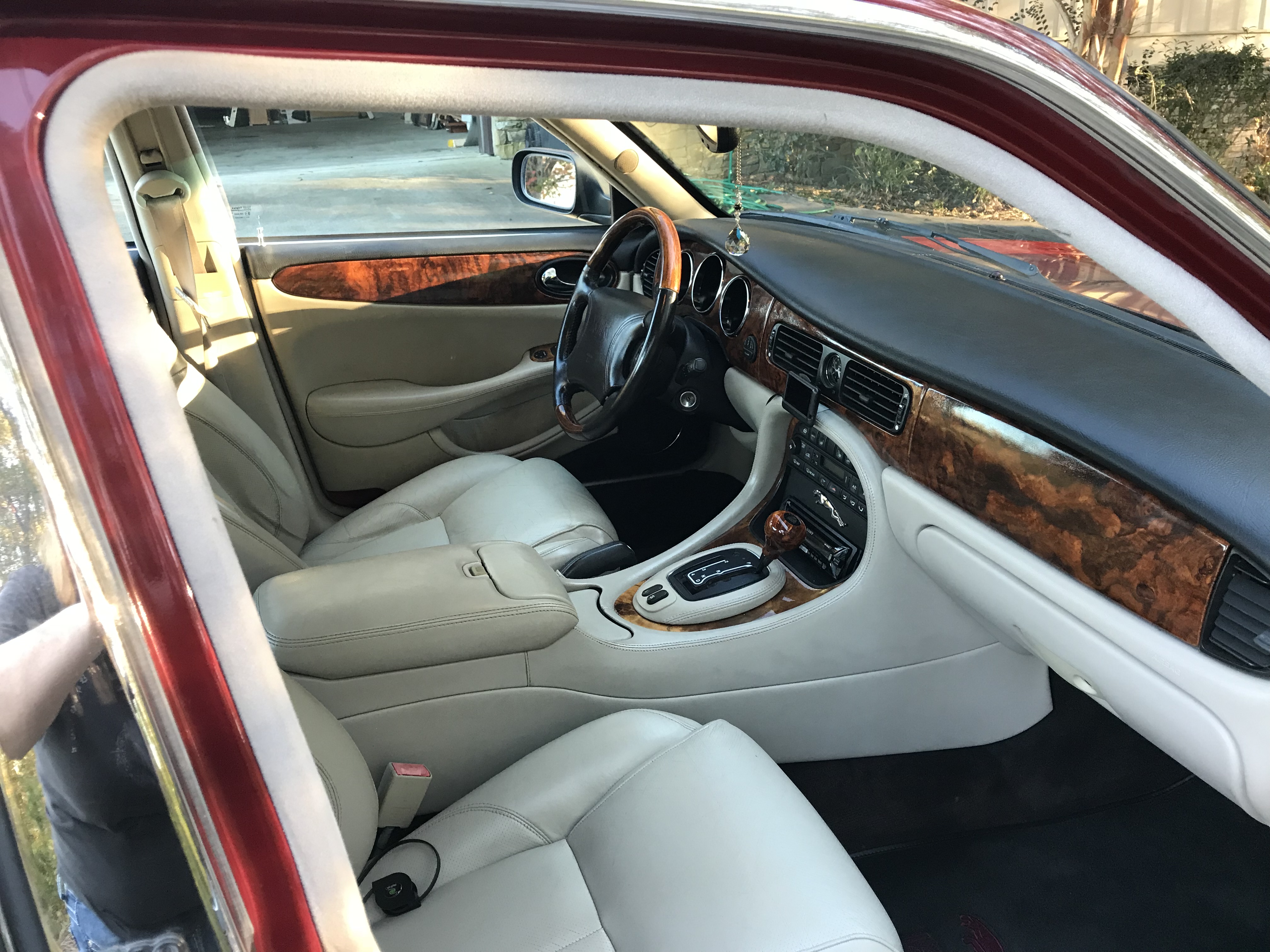

I detail cleaned the interior and finally got around to taking pics as I promised months ago showing her post restoration .

Looking sharp Jennifer !

Glad to see you are still around, well done!

I started a deep interior cleaning today as well, I got to all the plastics & wood w/ Meguiar's natural shine protectant(I'm fond of low gloss on things other than glass interior-wise). Tomorrow I plan to clean all the leather w/ Gliptone cleaner, followed by a lengthy soak /w a heavy coat of Gliptone conditioner. The carpet's in good order as it was cleaned by the guys @ the shop whom felt bad about a muddy footprint incurred when they rebuilt my transmission on the residual test drive.
Feel's good having the car in fine form cosmetically as well as mechanically !
