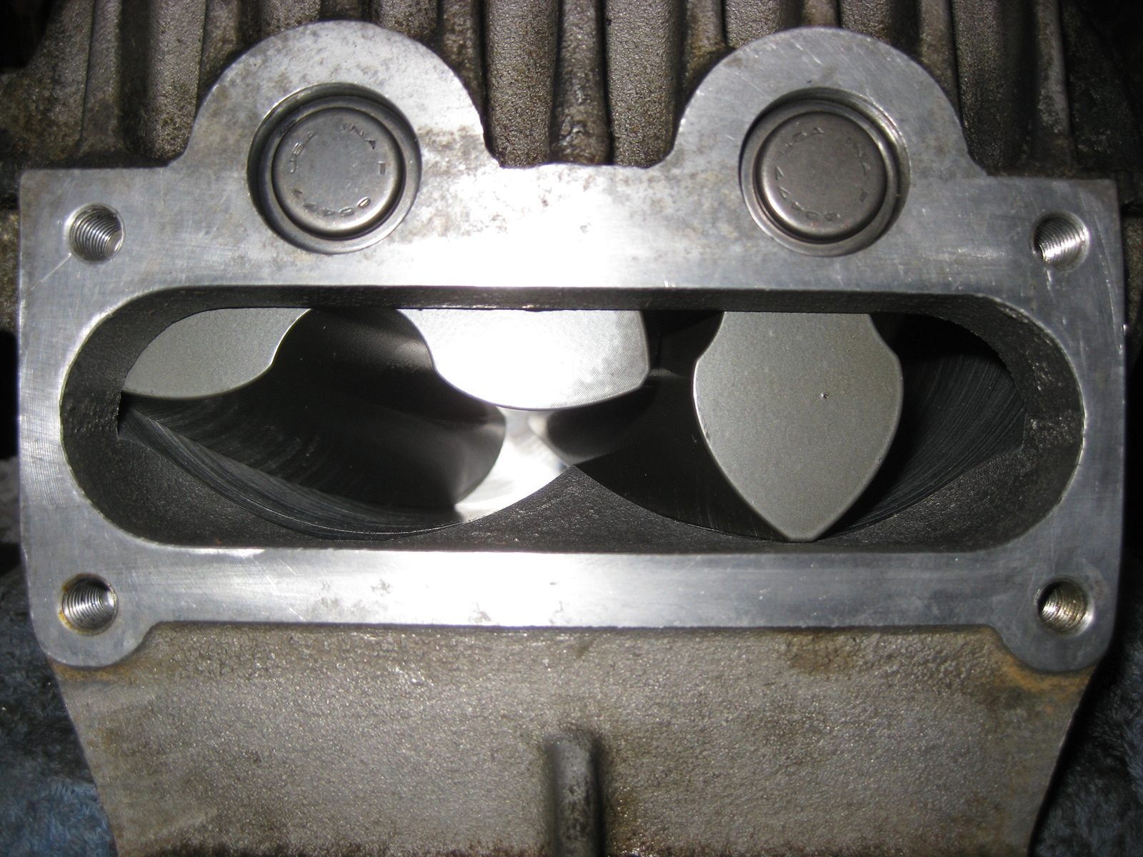

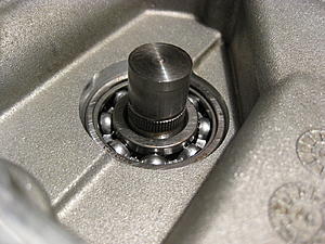

Removed the supercharger today to replace the snout bearings and rear needle bearings. Had a cockup using a slightly too large socket to press out the internal drive gear which got stuck inside it. Didn't think much of it at the time but on reassembly i found the internal diameter has been slightly enlarged so it wont fit snug onto the input shaft any more
If anybody has a spare one you would make my day..
