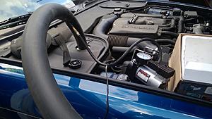

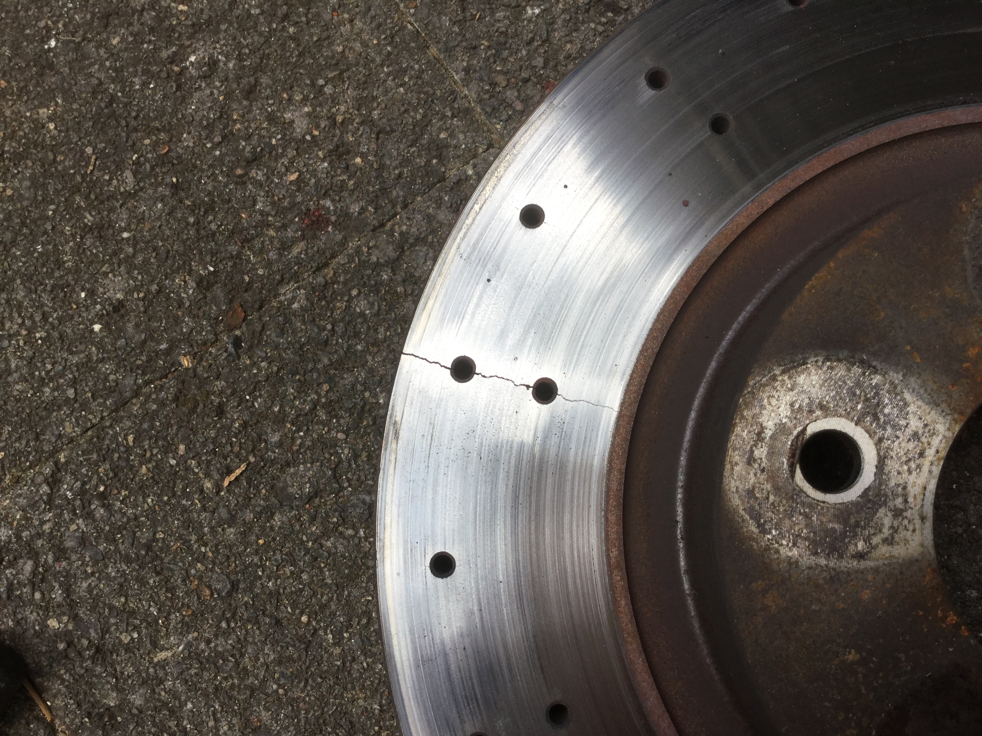

Replaced the rotors on the front of the car due to one cracking and the other showing signs of cracks starting.
What did you do to your X308 Today?-f9ceb7dc-c81b-4283-9243-e6dabfa465de.jpeg
This was my Heath Robinson gizmo to pressure bleed the brakes Cost $0.00

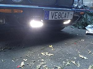

Also fitted up a pair of day time J lights from China I think they were about $9.00 for the pair, may have been each but still cheap
What did you do to your X308 Today?-367a05ae-a816-4f1c-a3b1-b786a796b520.jpeg
What did you do to your X308 Today?-95d2e897-a5fc-4ba7-8122-a965c321a2c9.jpeg
