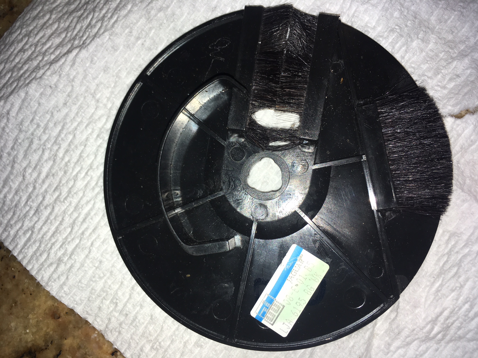

Well went to a big box store & on my return to the car it would not shift past reverse. No codes/messages so I thought that w/ the J-Gate recently being dismantled for the light replacement, that maybe something had come loose or broken. It was the screw on the left that seated the shifter rotator mechanism it had come loose & was protruding enough to stop further shifting. The thread in the hole was stripped, so for now the 2 screws are removed & it's shifting fine.
I'd really hate to have to replace the whole shifter after all the grief of getting the lights finally working. But the E-Bay hunt is now on.
Edit :
Anyone have a J-Gate diagram w/ part #'s ?!

Originally Posted by harvest14
Is it basically the whole collection of parts that constitute part number 3?
It's the semi-circular part that rotates when you shift. Maybe #22 or 23 ? I just had Lasik, so I am hindered vision wise.

I have one of those somewhere in the garage, but I suspect it's different than yours. The part numbers for that whole piece are different; yours being an XJ8 and my parts coming off an XJR. I will try to find it tomorrow and maybe provide a picture.
Perhaps that semi-circular piece is the same? Not sure....

Default This?
I just pulled this out of a box. Does it look like what you are talking about?
Yes but let me re-check tomm. in the light, to be 100% sure. It maybe the part under that(that houses it).
Thanks !

I'm convinced this is the part, as you can see the backside has 2 screws & one I was having strip issues with, right now I have it out not sure what problems can arise from that lol.
