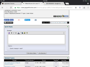

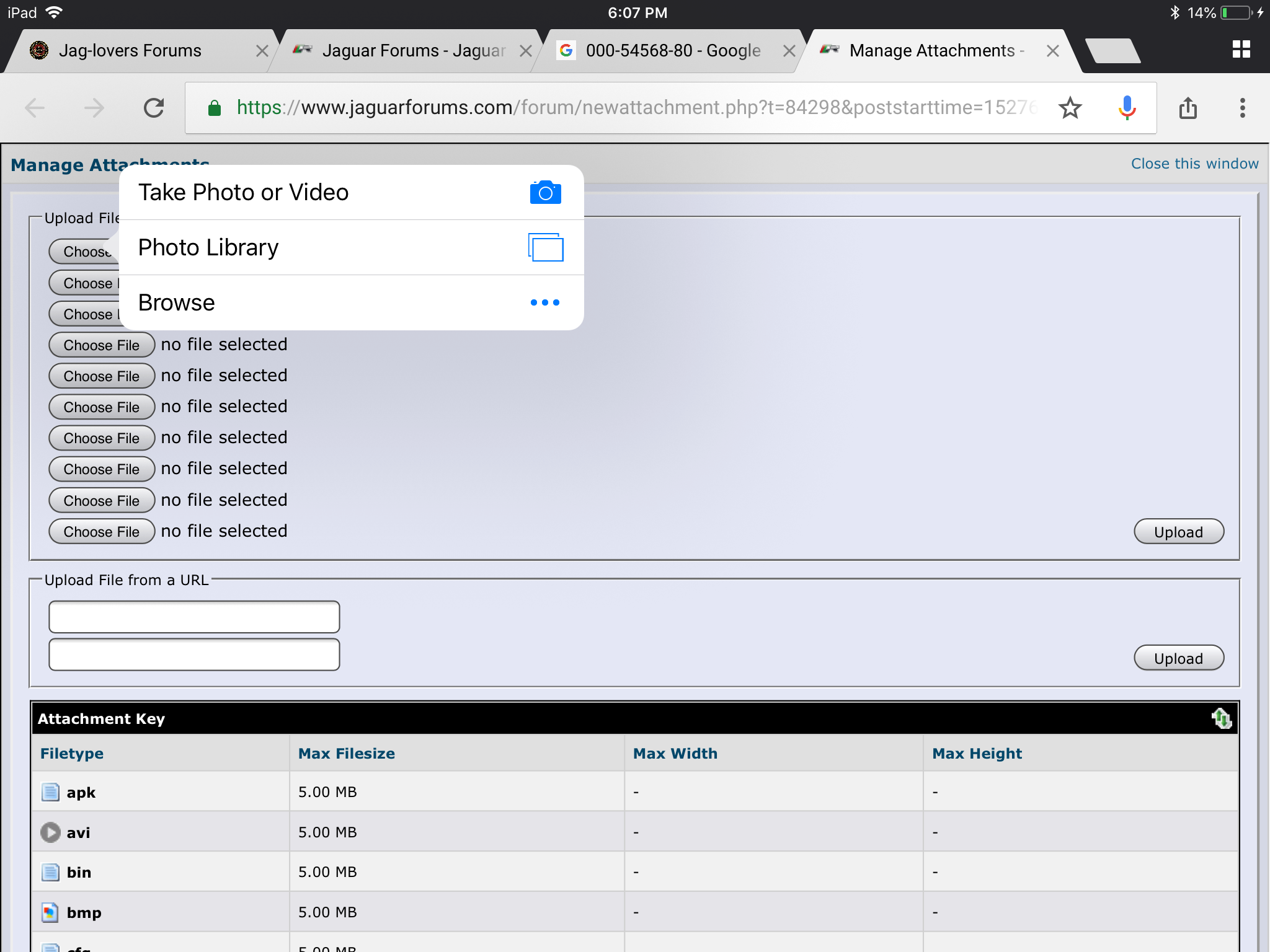

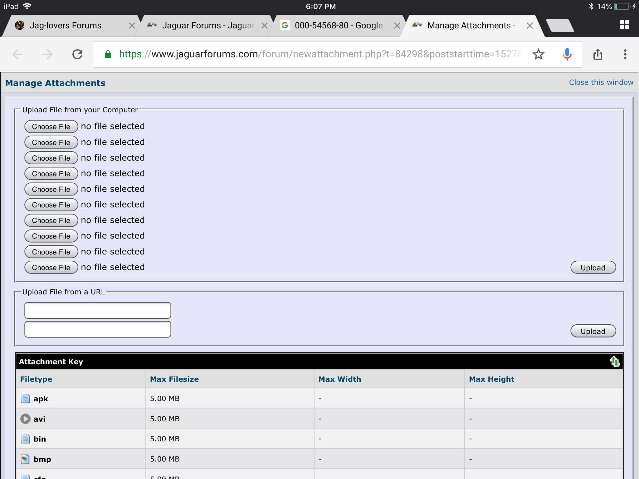

Post removed by author, not sure why I can’t remove the screen shots
Attached Thumbnails What did you do to your X308 Today?-ada7599b-64a4-42b0-b717-8303bf590f3e.png   What did you do to your X308 Today?-70f61a8e-9de6-46fa-8c77-5afdf4d7354e.png   What did you do to your X308 Today?-a07dc9c8-cf2f-45c3-8c89-5a08f359212d.png   What did you do to your X308 Today?-5949306f-e06e-480c-b97a-f4d9a901ce4c.png
