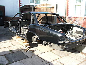

Originally Posted by Daim
Ready to go now
Been there, done that.....
