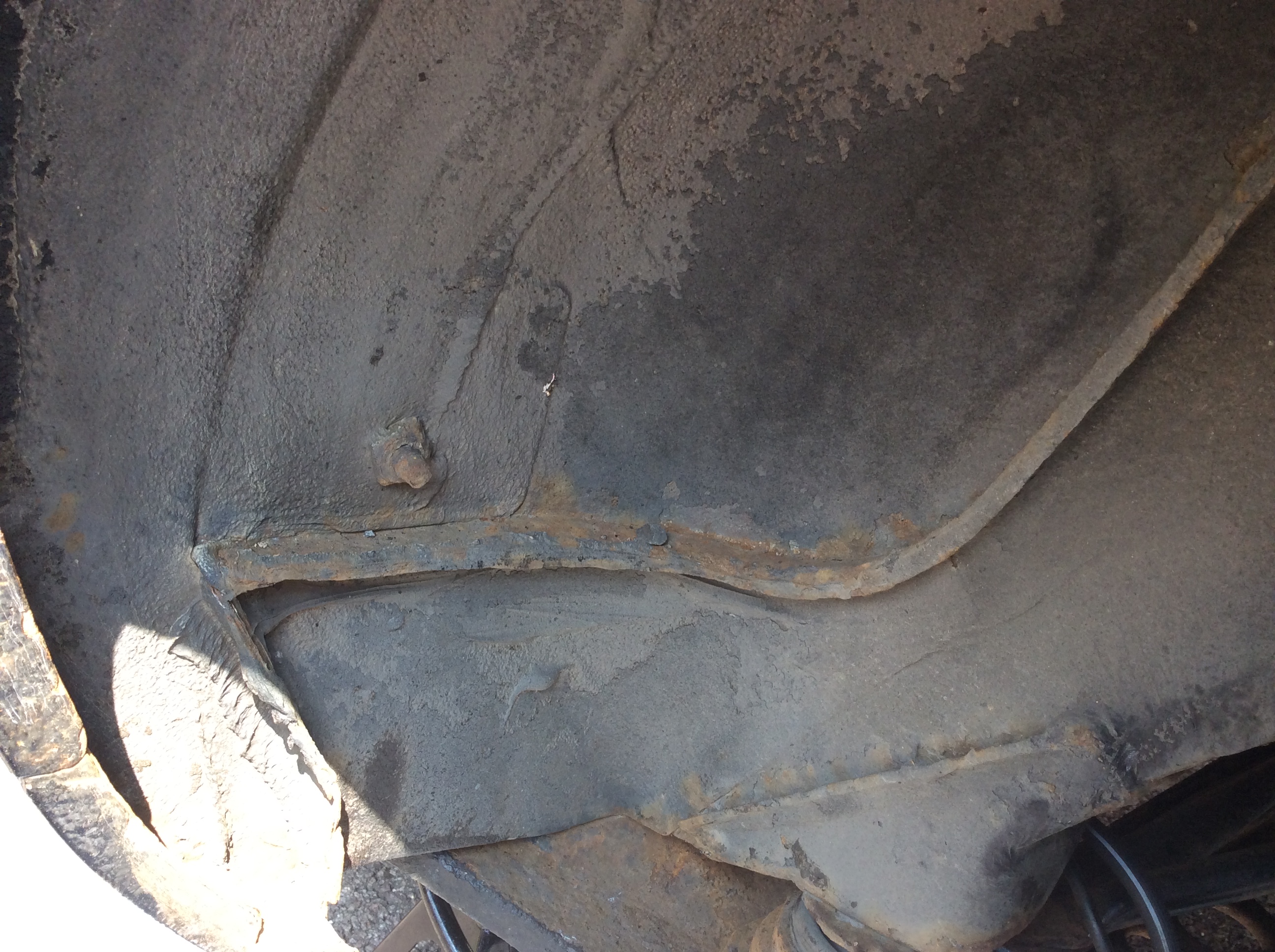

What did you do to your X308 Today?-image.jpgFinished waxoyling on the rear end today here's a before and after

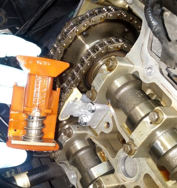

Upgraded secondary timing chain tensioners. Total of about 3 hours with the help of good ol Buck.
I have to say, working in the non supercharged engine bay is much easier.
57K on the clock.
Tiny cracks just starting. See attached pics.
This install was a breeze. Everything co-operated nicely.
