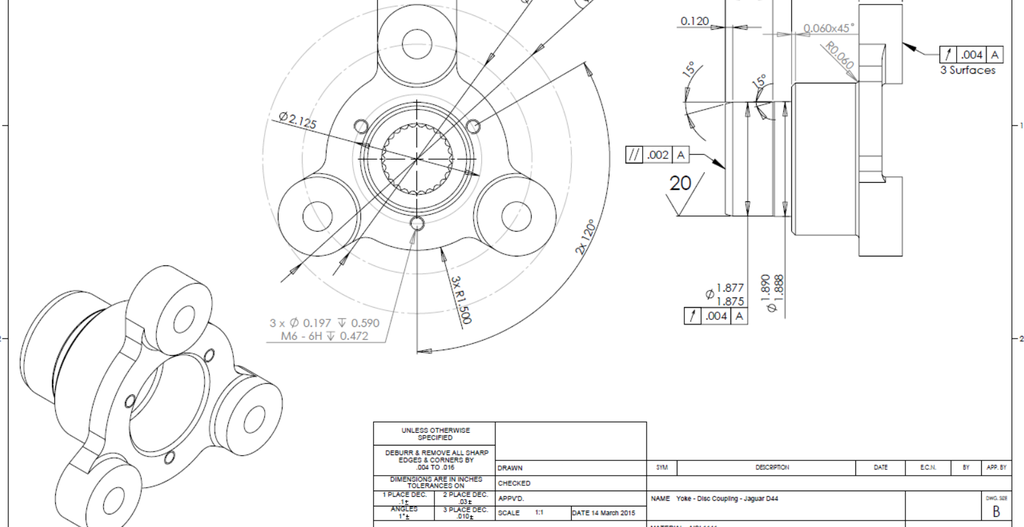

Extensive design work was done in order to fit and adapt Dana 44 internals to the 15 HU casing with 30 spline Dana 44 Torsen T2R (like some of the racing Mustangs use)

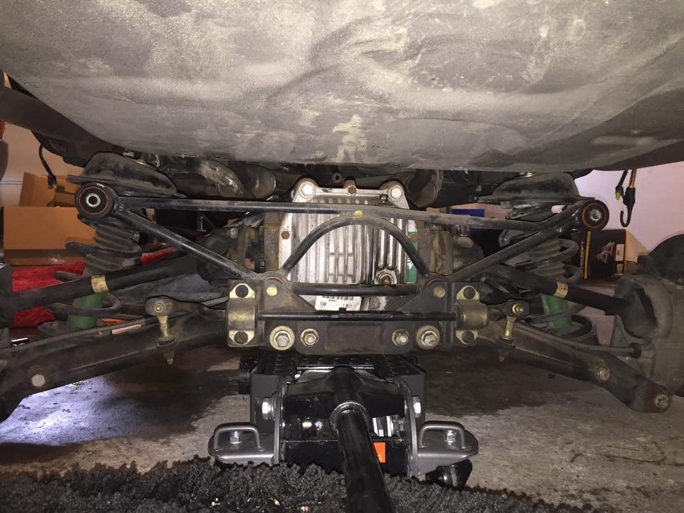

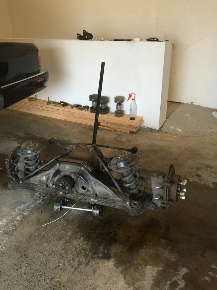

And it will all be going into this

Great work there Count, looks like you've engineered the weak link out. I must crack on with gathering parts myself as it's the last major job on my R. I may go your route and have adaptors made, what did the parts cost to manufacture?

My solution uses the performance oriented Torsen T2R LSD which has a 4:1 TBR or Torque Biasing Ratio. This means the TORSEN T-2R can deliver up to 85% of available torque to the wheel with traction. At lower levels the unit will behave like a conventional TORSEN T-2. This is particularly useful to drivers who compete in road racing and auto-crossing. Read more about it here:
T-2R (RaceMaster)
......Unfortunately- my original 14 HU diff bolt to stub shaft CV joint is jammed on their as the bolt is rounded -so I'm trying to grind it off. I don't need this today!!

Been trying to grind off a fastener from a rounded off bolt of the rear axle/diff assembly
Have prepped and shot blasted the new 15 HU diff casting ready for powder coating
