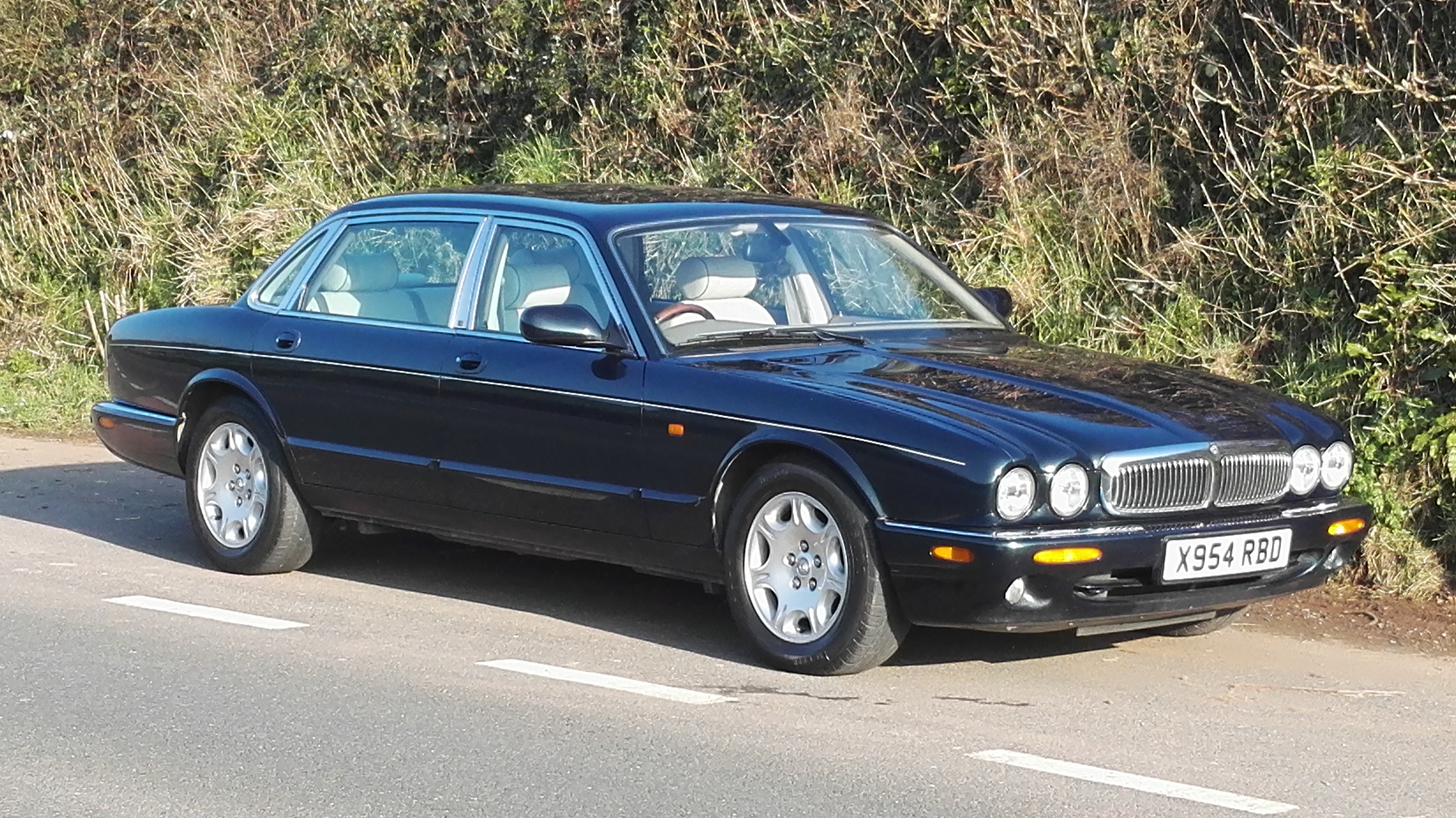

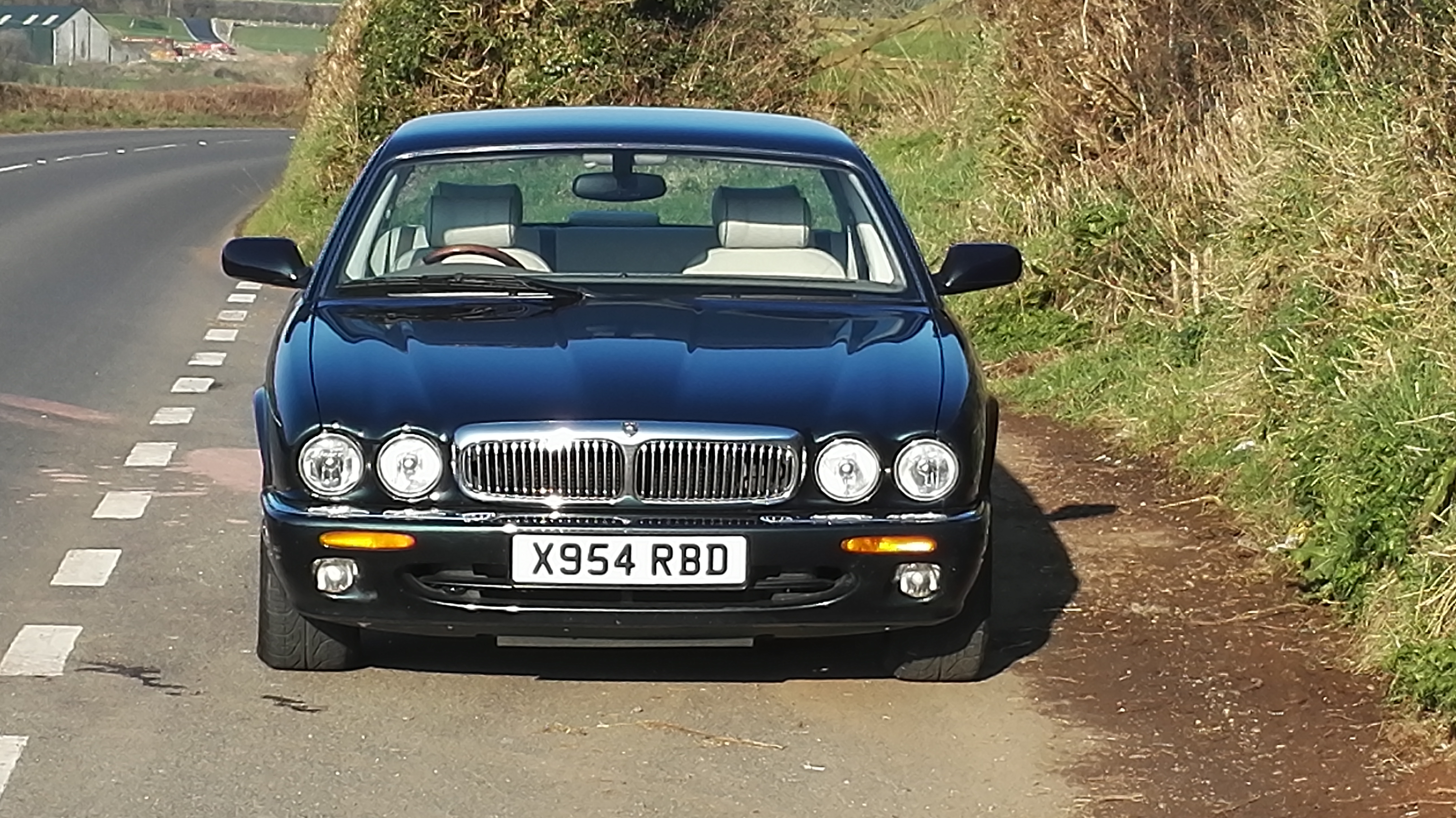

Smile
Hi everyone,yesterday I gave the car a good clean and as I've only had it since last Nov and use it as a daily driver it takes me all day to clean,it usually starts off like,I'll just give it a quick hose down and that'll do but then the chamois comes out to dry it off and then the polish and I just get carried away and then there's the inside to do,hoover out,leather cleaner out,wood to polish and after all that I stand back to admire and then I think glass must do the glass,so today I drove over to visit my mother which is about 40 mile round trip,It was a nice sunny day and the car went lovely and looked good,It's only when you see photo's of your car you notice the things you have missed,I shall now have to clean the inner wheel arches(lol),even took a couple of photo's,hope you like them as much as I do.
Take care
Enjoy your cars
Andy
Beautiful looking!
First time cleaning the wheel arches, take your time to clean out all the dirt and mud collected behind the lips, that is more important than the plastics.
Try using some different hard brushes and plenty of water to soak it, to get it out.
In your climate, you might want to add some extra protection there, not sure what's the best.
Anyway, after the first time, it is rather easy to keep them clean at every wash.
On the inner plastics, I do them with the same stuff as I do my tires with, it leaves a shiny layer, and prevents road crap from sticking.
Much easier to hose it off the next times.
