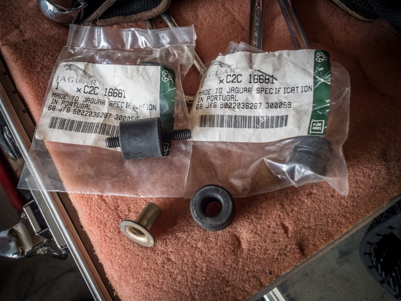

I had noticed the grommets that hold the mounting bracket for the supercharger coolant pump had deteriorated. So I looked them up on my SNG Barratt Catalogue. Part number CBC 8262. Checked with my local Jaguar dealer who confirmed the number and would you believe it stocked two. At a considerable price, Euro 11 each! Still, as maintenance cost for my XJR go, this is peanuts. So I popped over and bought them. But when I got them they looked to big.
Still, took them home. Sure enough by the time I got the old ones off, they were clearly to big. So I did some further digging into various bits of documentation. Appears, this used to pn CAC6426 and has been replaced by CBC8262. However, Jaguar got it wrong. It just won’t fit.
So I went back to the dealer. I went through some parts drawing until I found a few grommets that sort of looked similar to the old ones. Luckily, the guy had those as well.
I had to take the air filter housing off to get at these grommets. Noticed that one of the mounts had completely sheared off! According to my Jaguar parts guy the Jaguar part would cost Euro 75. Really, for a piece of rubber. He suggested I try the landrover one, one Euro 10. I like to keep my cars original, but this is ridiculous. The landrover part did fine!
Here you can see the original grommets:
The new ones:
The air filter with the broken mount:
Jaguar old and broken, replaced by Landrover new and shiny (and cheap!)
The new proper grommets, the new mount for the filter and the spacer that goes into the grommet. I managed to somehow loose one of the spacers. My part guy did not stock it, has to come all the way from the UK. Will take a few days and a few Euro’s only.
Job nearly done.
