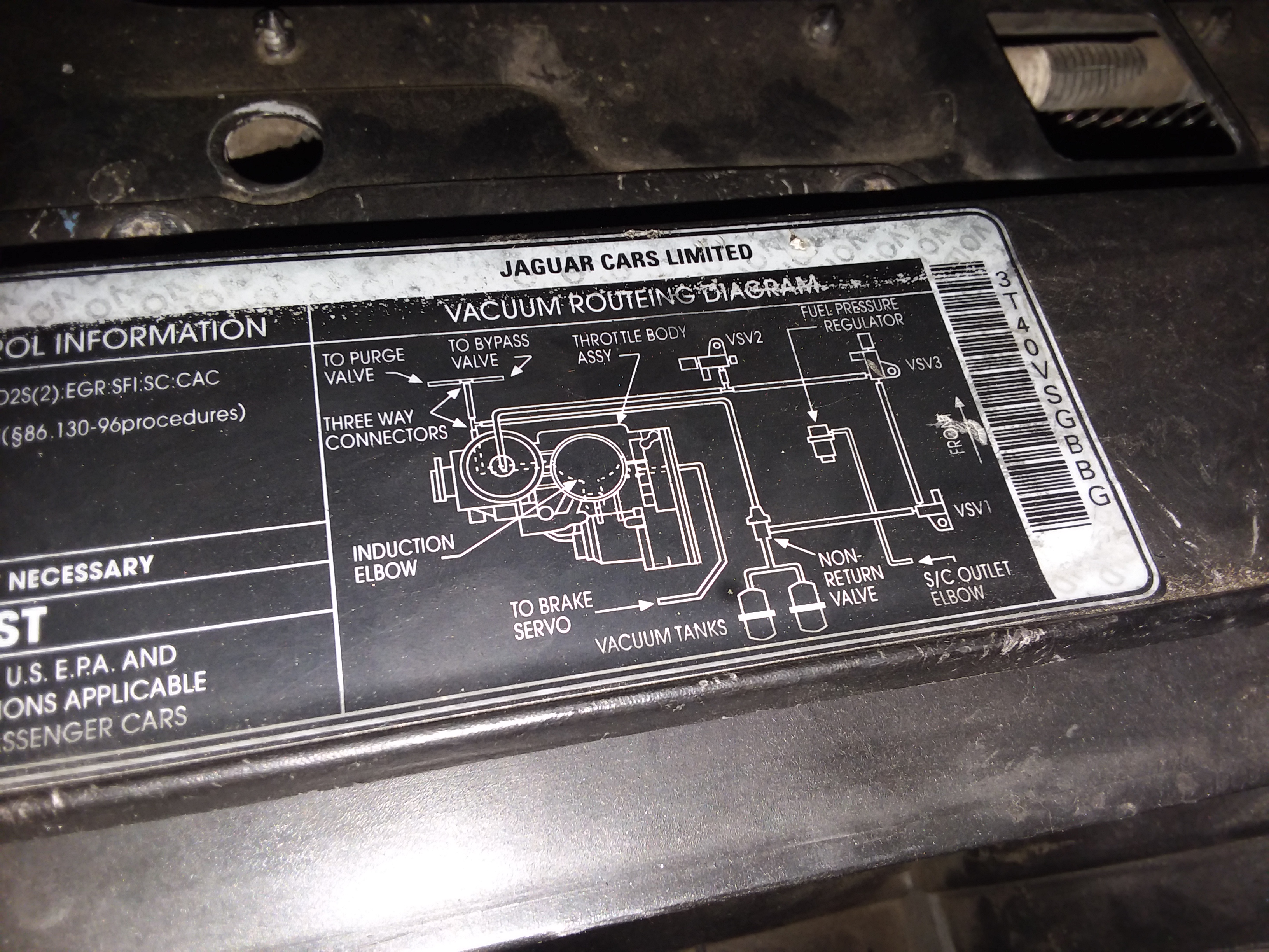

Reserve vacuum tanks (for cruise control?). Attached pic is for S/C engines but you get the idea.
I think these went away with the AJ27 engines.
That looks like them. It also looks like what ever needed them wasn't getting them AND I had a vacuum leak.
With a new T, at least they are hooked up, now, whatever they do.
